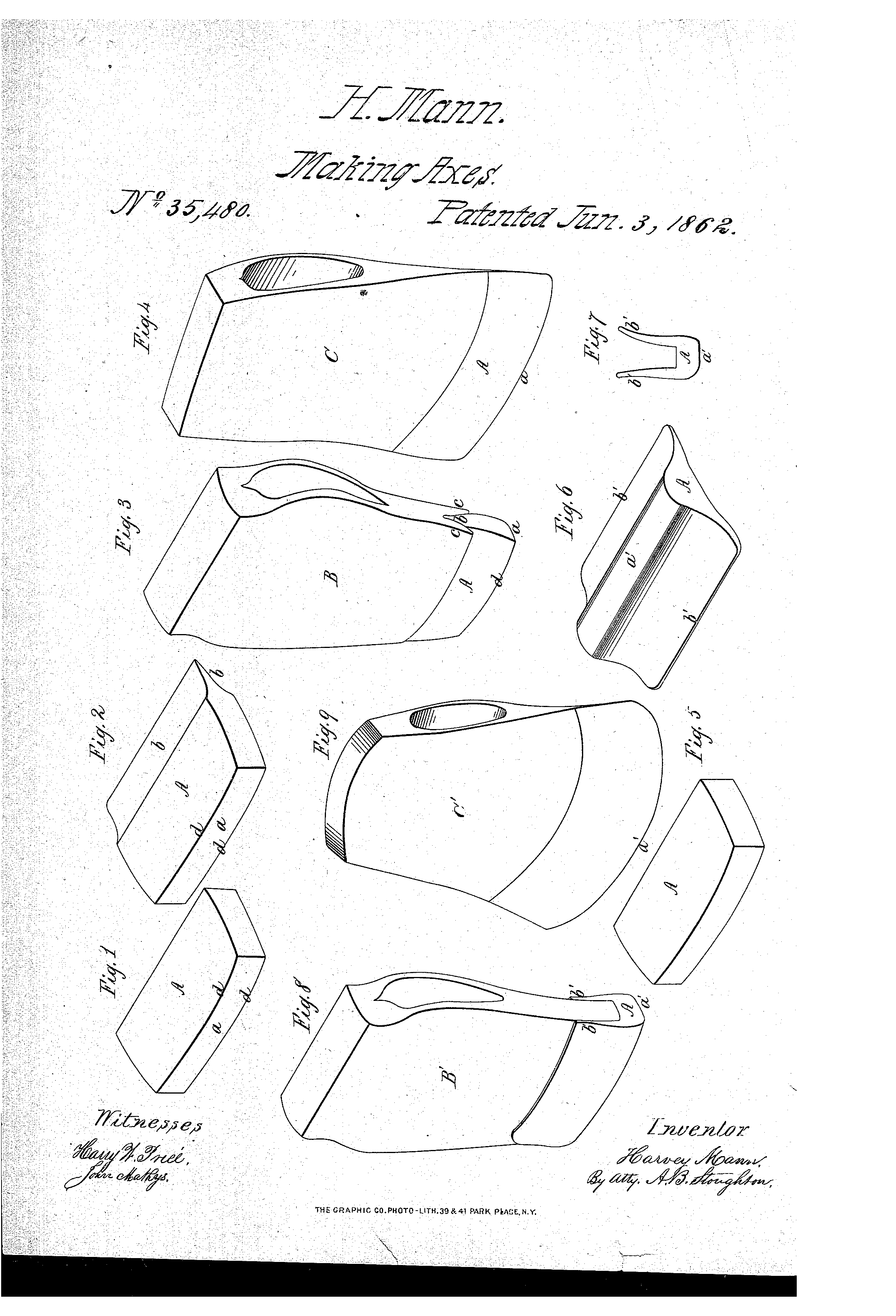

In 1862 Harvey patents the overlay method.
https://www.google.com/patents/US35480

Thanks, Bob. Very informative post. It's interesting that both methods, inlay and overlay, were in use by 1862.
With the inlayed axe even a worn axe could be drawn out by a blacksmith and he would still have high carbon steel at the bit.
1/8" more steel? Mann's own patent above shows 1-1/2" more usable steel. We've seen plenty of axes on here where the temper line is near or at the end of the bit. If those are overlaid axes then they're already past the hardenable steel.
And I've never seen an axe where the steel or iron behind the bit abraided away so I see little advantage to the 'larger steel surface'.
I can't speak as to why one type of connection would be stronger than the other. The forge welds appear to have similar surface areas.
Which Mann (Harvey or Joseph) and where is the 1 1/2" indicated?
Bob
"The advantage claimed in favor of the inserted bit is 1/8 inch more available steel."
I was being generous. It's probably more like 3" of extra usable hardened steel. Assume a standard full size eye of 2-7/16" wide. The insert gives you much more than 1/8", more like 3 inches. What would you estimate is the dimension indicated by the ?" ? Does it look like more than 1/8"?
It most certainly does! But the purpose of the patent is to show the buyer how much steel is in an inserted bit. What he is saying is that fig. 3 is an example of a bit with a small amount of steel. He is not saying that ALL inserted bits are that way. Comparing figs 3 to 4 is apples and oranges when it comes to overlaid vs inserted.
"For example, the body of the ax may be made of low grade steel and the bit of high-grade steel, the latter adapted to receive the requisite temper to hold a sharp cutting edge. The differences in cost between the low and high grade steels is considerable, and therefore, while it is necessary to the production of a thoroughly serviceable tool to employ a certain proportion of the high-grade steel, it is nevertheless practicable for an unscrupulous manufacturer to derive a considerable profit by omitting to use such a proportion of high grade steel as may be necessary to produce a first-class article."
"My invention is designed to facilitate the detection of attempts to practice fraudulent imposition and to afford means for readily discriminating between an inferior and a superior article."
