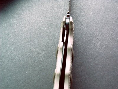

Here's a picture of the locking side of a Hinderer XM-18 framelock. That section that is cut away shifts to the right when open to lock the blade in the same fashion as a liner lock. The ZT 0300's work the same way:

Arh - thanks guys that finally makes sense now!
I was trying to imagine the difference and now I can see it.
Certainly the framelock looks a lot stonger than the liner lock!
man those XM18's look sweet, if they were not as rare as hens teeth I would be getting one of those, especially with the flipper they look fantastic, still I am sure I will be happy with whatever i get in the meantime and it gives me something to aim for...
Also gripping the frame lock actually tightens the lock and prevents it failing on you.
