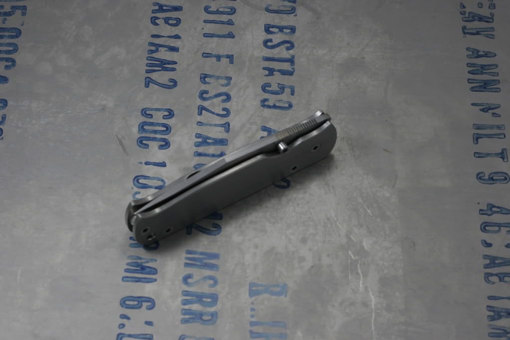

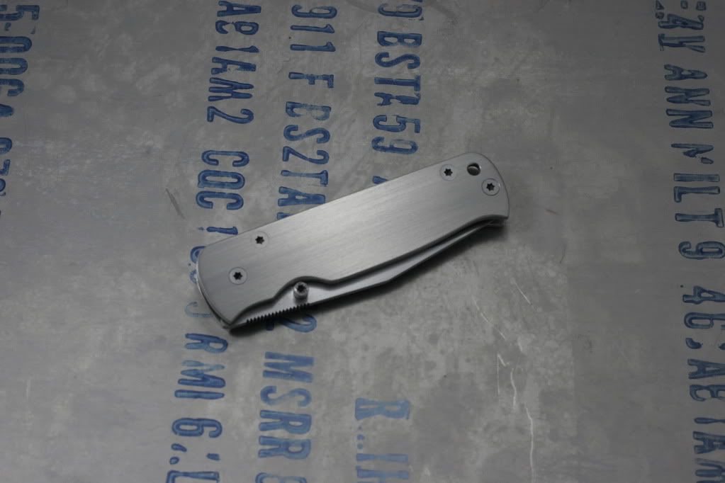

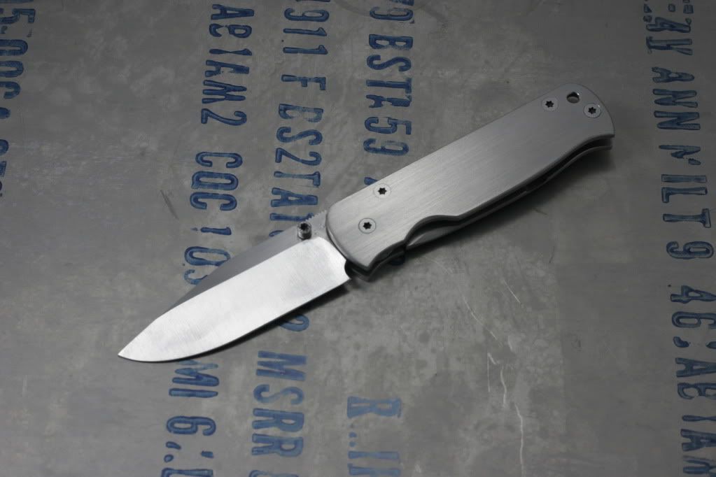

I like the clean appearance.
In comparison to your other knives on photobucket, this one seems particularly clean, probably because of the countersunk screws.
I'm curious about the grooves on the back of the blade (near the thumbstud) - what are they for?
The countersunk screws are custom made so I can get the right look.
Great looking knife I like a lot.
I am curious about the thickness and wide dimensions of the blade.
Congrats
That is one clean looking folder! Simple and elegant, but it looks TOUGH!
Nice work.
Thanks
Its built tough first, looks later.

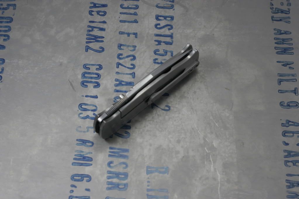

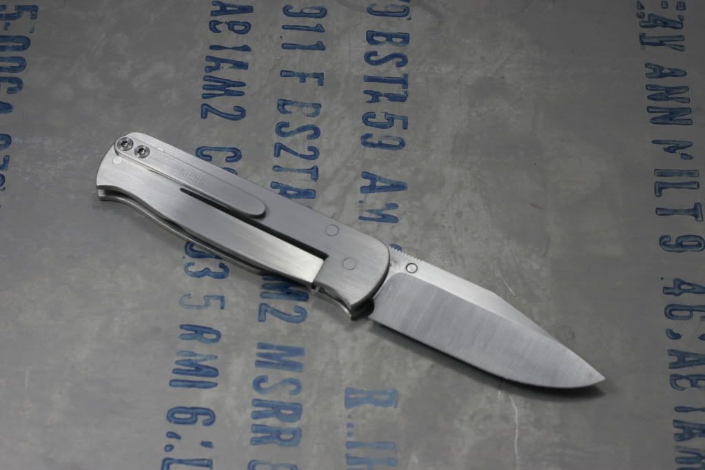

I made the pivot and stop bolts myself so I know they will be strong. They are hand turned from 6mm diameter stainless steel to 5mm diameter and I cold formed the Torx heads with a gadget I made especially for the purpose.
The spacer bolts are also hand turned so they are strong and look good too.
I also made the blade tips a little thicker so they are less likely to break. I wanted a stronger clip so I made that too, ground from a solid piece of titanium.
It can be disassembled with a single Torx driver.
