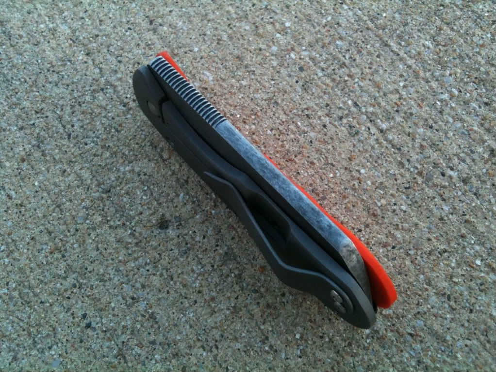

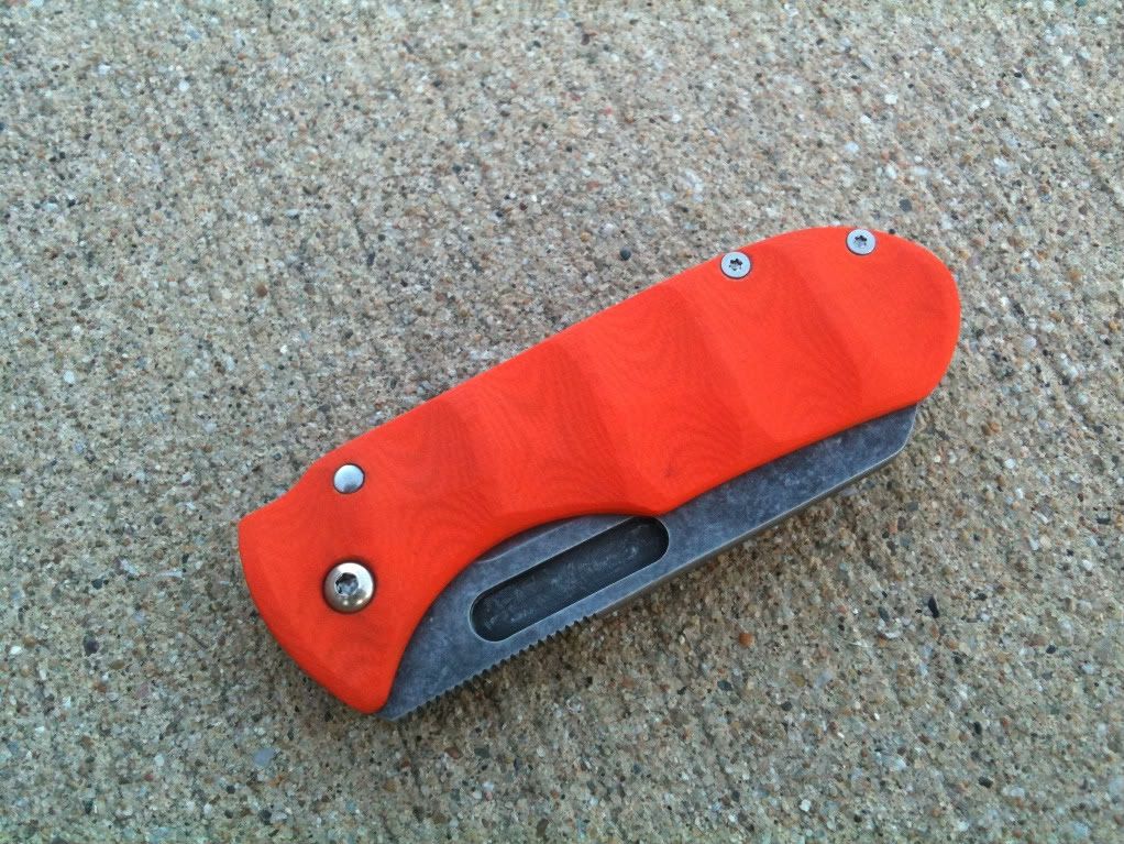

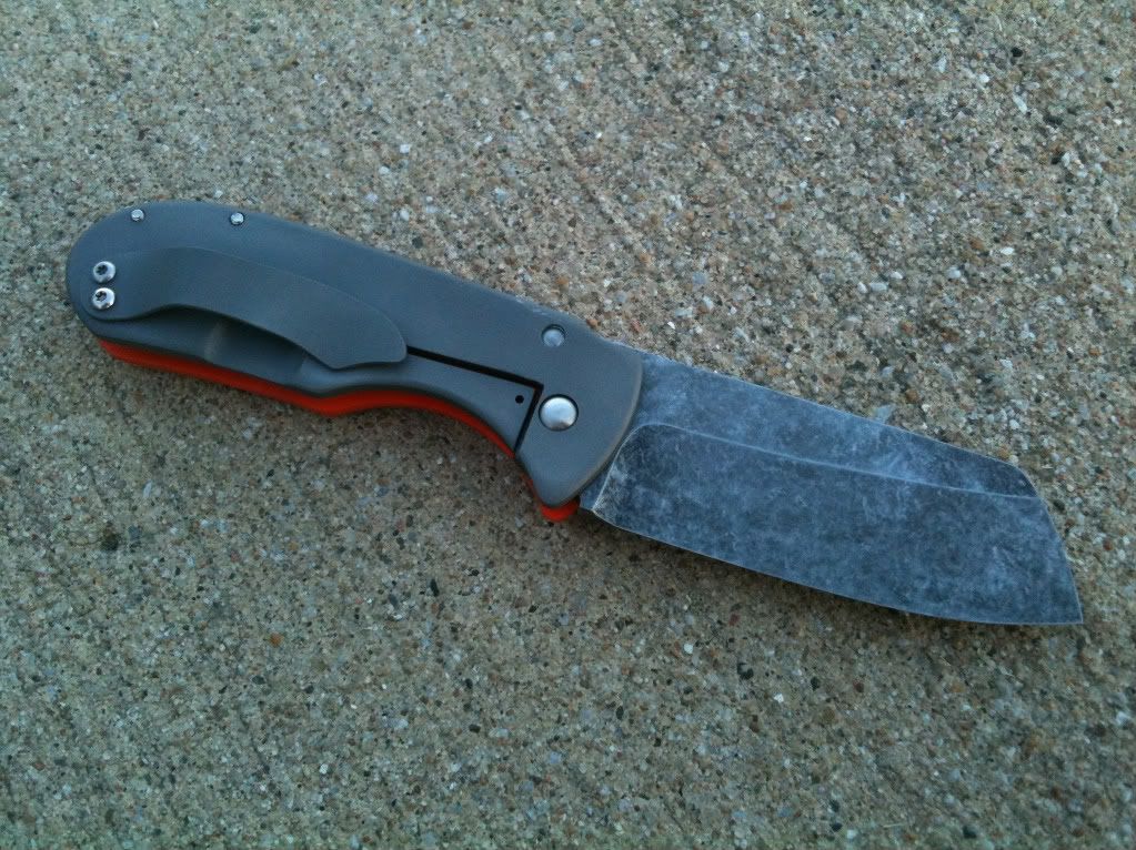

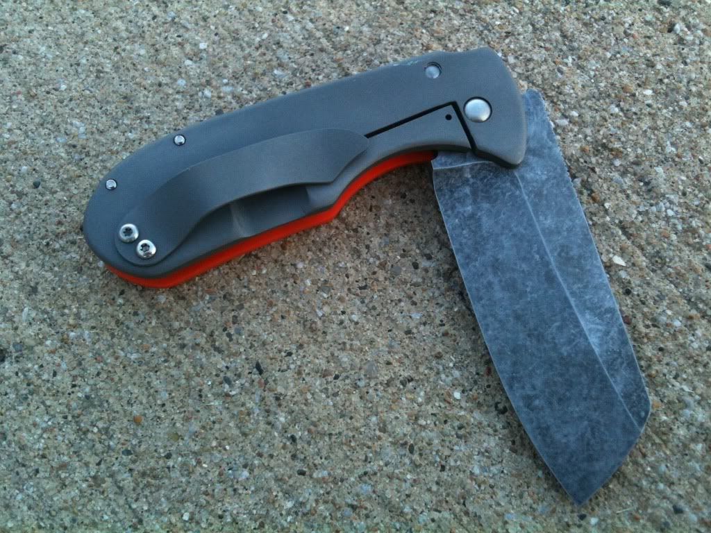

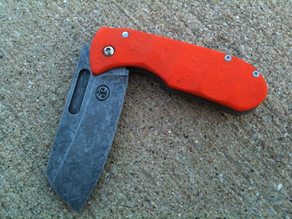

Hi all,
Would like to share with you my 6th locking folder off the bench. I think this is my favorite so far, definitely seems to be the smoothest working one so far!
I really love the Sheepfoot blade profile, all utility! Its got to be my favorite
I just had to incorporate it into this handle profile I've been working with. Had to get this one out of my system so to speak, now its back to finishing up some orders so I can start focusing on making a bunch more of these in the future.
Specs:
3/16" stock 1095 blade measuring a little over 3" with a dark tumbled finish. Milled in thumb opener. (This one really feels like there is a lot of blade packed into the design on this one)
Orange G10 non-locking scale, grooved and beadblasted finish
.0125" Ti lock scale, slightly contoured with a beadblasted finish.
Ti pocket clip (tried something a little different by following the contour of the handle, I may knock that little horn off, not sure what I think about it just yet)
Blue/black G10 backspacer.
S/S hardwear througout, satin finished.

I like it, hell I'm half tempted to buy it but the ti side and clip look a bit plain in comparision to that beautiful blade!
