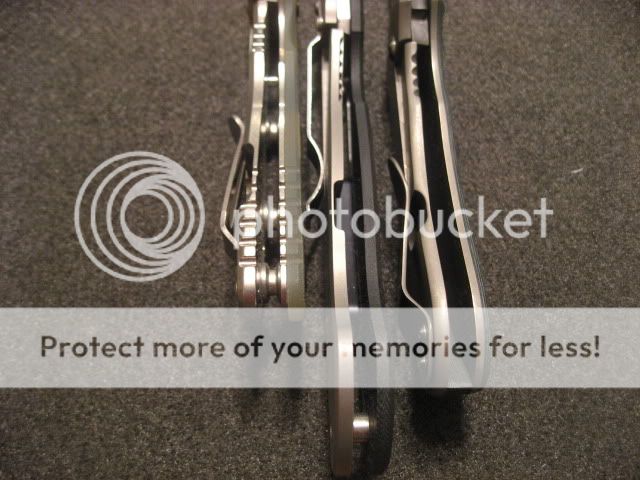

Out of curiosity, are there any pros/cons to the relief cutout being made on the inside or the outside of the lockbar? I just picked up a Spyderco Military and it is the first framelock (RIL, I guess), I have had that has the cutout on the inside.

Thanks ROBB. Good points on the wear issue. While I have never had any problems with wear on my ti framelocks (maybe haven't used them enough? :D), Spyderco addressed that with a steel insert that you can kind of see in the pic. I have heard other makers are or will use this. It does seem to provide a very nice and solid lockup at about 50%.

I would really be interested in the rationalization that the cutout on the inside is not weaker than the cutout on the outside.
Obviously the more beefy the cutout, the stronger the lock. But for cutouts of equal size and thickness, the cutout on the outside should be stronger. I have never had a frame lock fail in that manner and have only seen one picture of one that failed by the lock bending at the cutout, and it had an inside cutout.
I added some lines to the above picture that depict the flow of forces from where the blade tang contacts the lock bar, down to the bottom of the knife. As I said I would be interested in the rationale of why one would not be stronger than the other.

I don't think the forces flow quite like that.

Why not? Any reason or just what you think? A cutout on the outside lets the force flow in a straight line from where the lock hits the tang down the inside of the lock bar. A cutout on the inside has the lock bar material offset to the side from where the force is applied. This creates a moment arm and the forces going around the cutout are going to cause a torque or bending motion at the cutout.
I would think the forces are applied just as FlaMtnBkr illustrated. Pressure starts where the blade contacts the lock bar and will stay towards that side. Granted, I rarely put reverse pressure on any of my knives so for myself I wouldn't care to much either way.
Because the forces are not distributed as a singular line, but rather on the whole lock bar. Either way the most stress will be placed on the start of the cutout.
