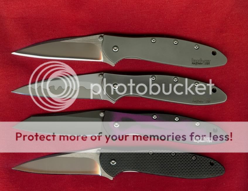

Since I lost my ZDP leek, I have been EDCing a composite blade model, but really missed the ZDP. I finally picked up a used one, and wanted to glass bead the blade and put it on the stainless handle. I'm probably one of the very few people that do not appreciate the TI handles. When I made the switch, the thumb studs on the ZDP are a larger diameter than the one on the comp blade, so 1 knife had play at the frame lock and 1 had interference. I ended up keeping the TI frame lock, putting the stainless scale on the other side, and lightly filing the area on the stainless knife where the the thumb stud hits, so both studs make contact at the same time. I gave the blade a light bead blast, but it is not enough to blur the grind lines on it, since the steel is so hard.
In all, with the interchangeability between various versions of the leek, I was suprised to see that not all models are interchangeable...

Yes, the Ti-ZDP Leeks are flat ground as well as the CB Leeks.
I've FrankenLeeked a lot, and I mean a lot and have never ran
into compatibility issues other then screw lengths when using
two different scales.
This is just a drop in the bucket with all that I have done.
By all means, FrankenLeek away. ;)
1- Ti-Leek
2- Ti with CB
3- CK&T S30V Tanto with P&B smoked aluminum scales
4- G10 with ZDP blade

I know that the G10 scales are much thicker than the all steel scales. How thick are the Ti scales compared to the steel scales? Are they the same thickness?
Also, and more technical:
Does anyone have fairly precise weight comparisons between the standard steel Leek, Ti Leek and G10 Leek?
No problem DWRW.
Same thickness on the Ti and SS scales.
The SS Leek is 3.1 oz and the Ti and G10 are both 2.3 oz IIRC.
