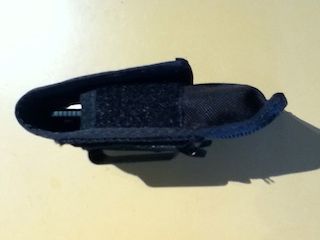

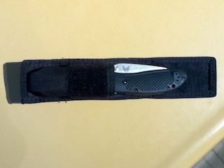

Ammo pouch with steel belt clip. Clips to non belt pants also etc.
Partly/mostly for those knives I prefer to use with the clip removed . . . for instance the Para 2 . . . though I put the Griptillian in the pouch because I love the thick handle (with the clip on for finger traction during opening) but I don’t like it in my pocket.

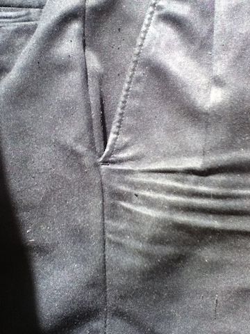

Of course I don't use the pouch every day. These are a pair of my work pants. Worn for years with a knife there every day. Lately it has been the GB 1 but many others such as the 710.
Not bad with the right knife(s).

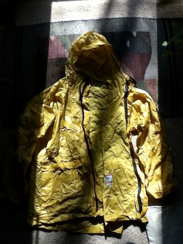

It isn’t like I don’t sew stuff. I made this rain parka. Anyone remember these old Frostliine Kits? Those were the good O’ days. I was a poor kid then though so this was the way to go.
