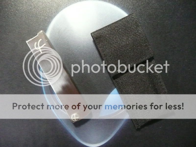

As for the Tri-Folder, it came in a black nylon pouch. Said pouch has a velcro closure system, and a belt loop for horizontal carry.
The knife itself rests VERY low in the pouch, with only about .25 inches exposed when fully seated. There is room for the knife to stick out more, so if you do decide to use the pouch, stuffing it will be a must.
It's also worth noting that the belt loop on the pouch in quite skinny. Anything much wider than the average leather belt will not fit through the belt loop.

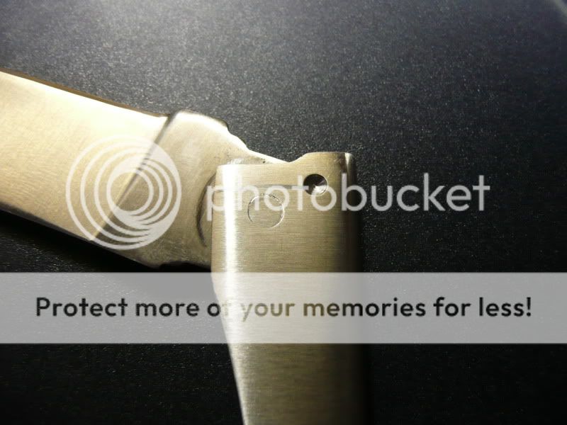

On first inspection, I can see the pivot pins clearly. They've been ground flush, and don't move, but I think that the people who mass produce this knife could have done a better job at hiding the pins for aesthetic reasons.
On the opposite side, you see a divot for a retention stub. It seems that unlike the earlier models of the Fred Perrin Tri-Folder, this version CANNOT be deployed without first getting over that initial friction. If held horizontally with the opening down, the arm and blade do not deploy. I'm debating whether I want to file the nub down or not.

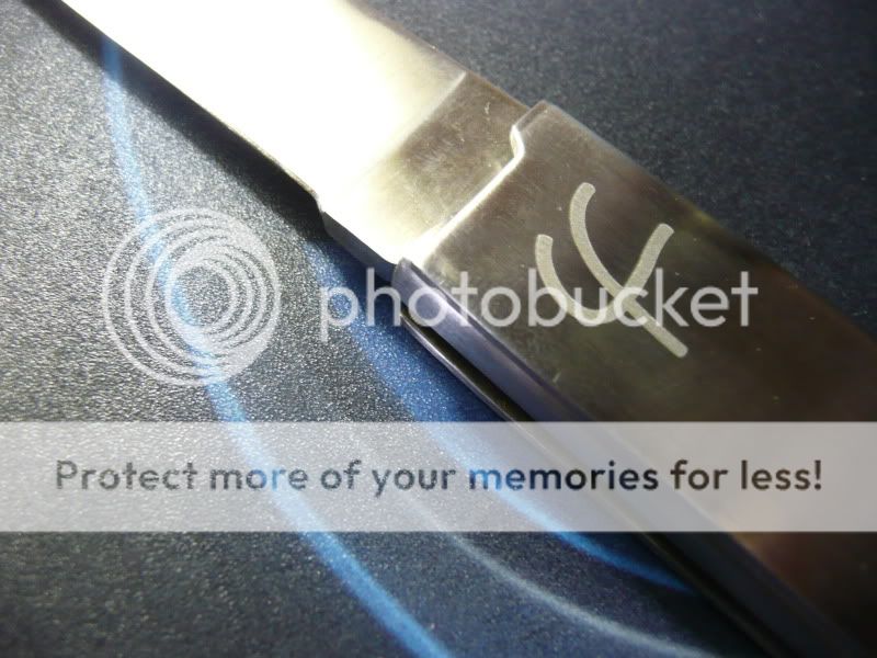

The lockup on the blade is decent. when closed, it's perfect, but when open, the blade allows the inner handle to rest recessed into the main handle, providing a small amount of room for the blade and such to wiggle. A go with a dremel or something similar will remedy this problem in no time. I might also try adding extra meat to the area of the blade where it meets the back of the main handle. The manufacturer ground down that specific spot for the blade to rest deeper into the handle, but perhaps ground too much or shouldn't have ground that area down at all. I think that by adding material there, the blade would not have this problem.
There is also a fair amount of lateral play to the knife. Perhaps avoidable with better tolerances, but it's not enough to detract anything from the knife in my eyes.

The only difference I see between mine and yours is that the divot on mine is so small, it has no effect on the blade dropping open. Nice toy!
