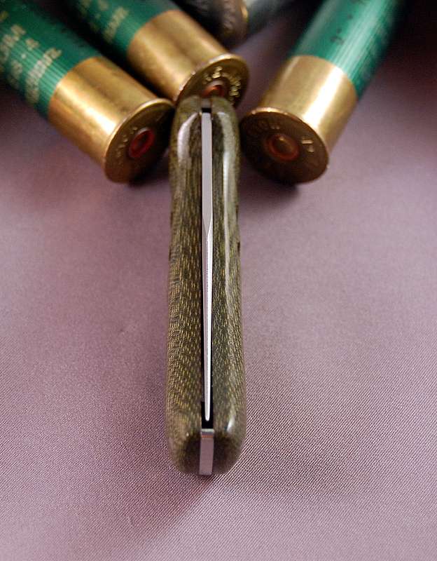

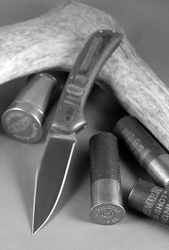

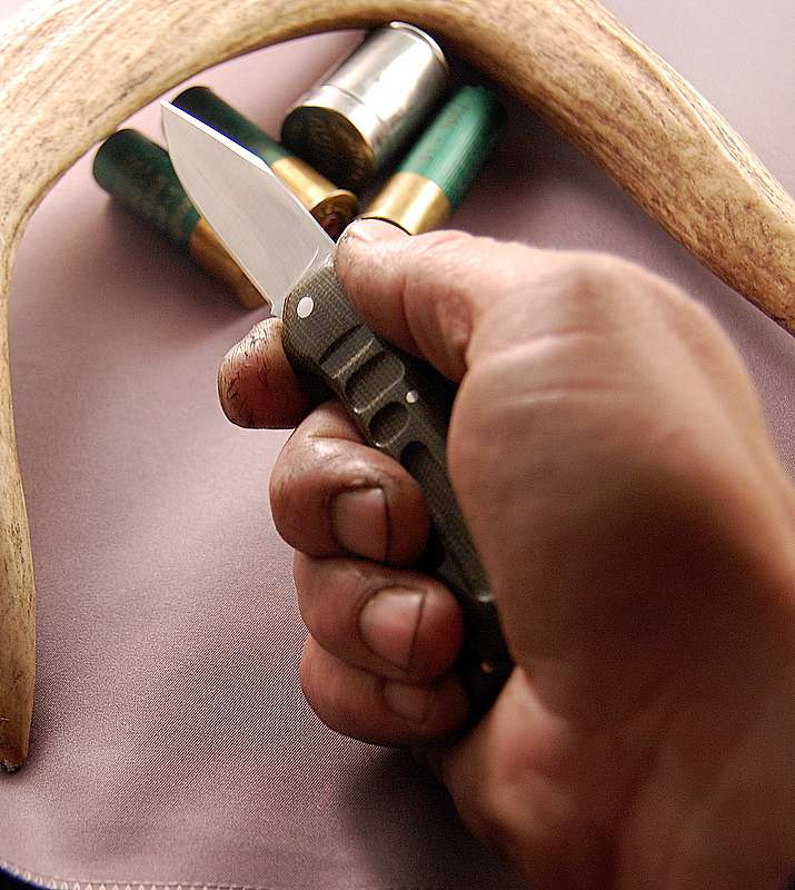

I am really enjoying the whole process in the building of a lock-back, after coming home I had to put some things on hold. I spent a few days working on a completely new design and decided to go with green canvas micarta to hold it all together. There is no blade play what so ever, the one draw back at the moment is I think it needs a pivot if I plan to do more of these, the pinning more than likely is damaging the blade to handle pivot area a little bit. It is smooth but it seems to be just a tad tight, the blade does not close on its own even though it worked before it was all hammered together. Before anyone gets to crazy I know it has some issue it is my second one, but by all means fire away:D
The bonus it weighs a Whopping 1.7 oz thats the same weight as a bic lighter so I decided to call it the "Free Fall" folder
I will continue to explore more possibilities with the lock back, and push my limits.
A 3" cpm 154 HRc 59 hollow ground blade
cpm 154 Back spacer and lock bar
Pivot is .125 ss rod as are the rest of the pins
Handle is GCM
Great looking one, Spencer. Really like the blade shape.
spencer...i really like the look of the cutouts on the micarta....and i like light-weight folders....looks good...especially for a 2nd attempt....ryan
Looking at that knife, it is amazing to me that it is only your second folder. It looks like you've been making them for years.

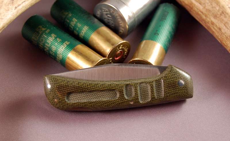

Hey thanks a lot, keith at this point no on the sheaths that was one of the reasons I choose the canvas micarta and a smaller size it will get lost in you pocket like a bic lighter or a pack of gum. I plan on using bushing in the next ones to get rid of any pinch which I new i would get from this conventional method. Keith further more I really think I may have found what I like about knife making in the lock-back design we will see what come down the pipe?
Lets see small one-check, mid size-check ummm only one direction to go:D

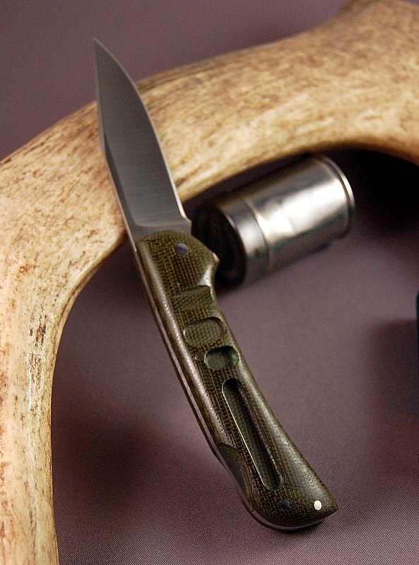

Feedback:
I love the blade shape.
I love the handle shape.
I am not crazy about the green canvas, but that's me and easily changed.
May I mention something in honesty? I really don't like these random milled pockets. Milling is OK. Just make a pattern that makes more sense. ( I would have liked that simple long mill going from front to rear, giving the scale an I-beam effect.)

Coop I understand what you are saying, sometimes i go to the mill with no plan, but each mill slot has a indexing handling function if that makes sense.

I got the stuff on order to fix the pinch problem ( bushings ) I have not decided at this point if I will add a lanyard hole, belt clip or provide a leather belt sheath?
