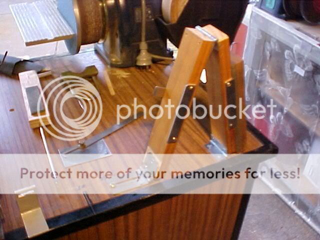

Yesterday I was going to make a holder to set my stones or strop on an 15 degree angle. Then what about 20 degrees or less then 15. So I was able to make up this holder from lexan, brass hinge, screws and support rods. Works great for stroping your knife at the same angle you have just sharpened it.

Nice work, but wouldn't it be easier just to lay the stone flat, and adjust the angle with the blade in your hand?
For many people that would be true, but there are also quite a few who are not confident about freehand sharpening. I think a device like this would be a good start for somebody a bit nervous about going straight into freehand. A sort of training wheels approach. :)

My only concern that plex will not hold this screw in for long because of constant pressure you apply during the sharpening. I rather put something solid in between flats making some bumps or holes to hold it in place for different angles.

I do feel that it is easier for a larger percent of those who sharpen freehand to hold the blade parallel to the table each time and know its 12.5 degrees then to lay the stone flat and know that you are at 12.5 degrees with the blade. You are more likely to be off by a degree or more with the stone flat then with it on a fixture and you holding the blade parallel to the bench. I think many more can tell if they are parallel then if their at 12.5, 15 or 20 etc. degrees.

Multiple angles possible:
I guess with enough holes you can have about 2-3 degrees increments thus setting the fixture at infinite angles.
Thanks, Vassili.
Vassili,
It is not plexiglass but Lexan. It will hold up "much" better then plexiglass. Those screws are 1/2" long and will take some doing to loosen up. The material is 3/8" thick with 10-32 screws.
Thinking about you other comment you have a good idea there. How about round stock, under the lexan sitting in half moon cut outs in the bottom of the lexan screwed into the two side supports? New and improved model :D

I am not saying it will fail right away, but after so much sharpening I can imagine it will lose in a few month or year. Especially when you change angle and screw/unscrew it a lot.
Yes this is what I was thinking, you put it in English much better then I.

Think I saw that one when you made it, much better looking than my one.
To tell the truth I never use mine now that I have the right wheels for my buff.Thank you for the comments about my knives and sheaths.
