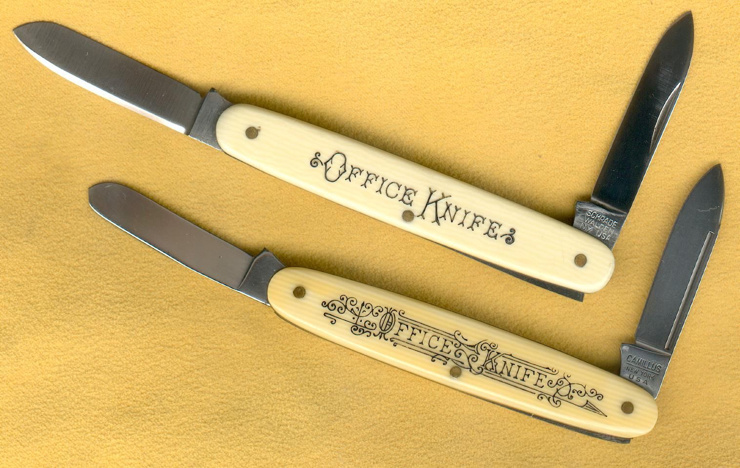

It was widely used. As one example, the "office knives" were commonly French ivory. Here's a pen knife that I sold on the Exchange...

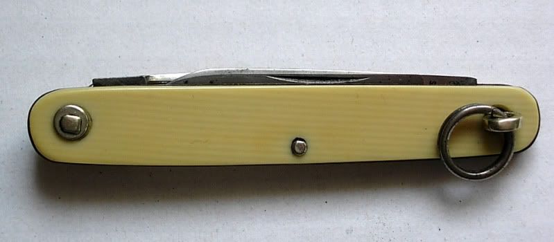

Here are a few knives that belong Monsieur Charlie
Apparently these knives were used for many years before the invention of "White-Out", to erase (scrape away) mistakes made in ink! An added spear blade to open letters made the tool more versatile.

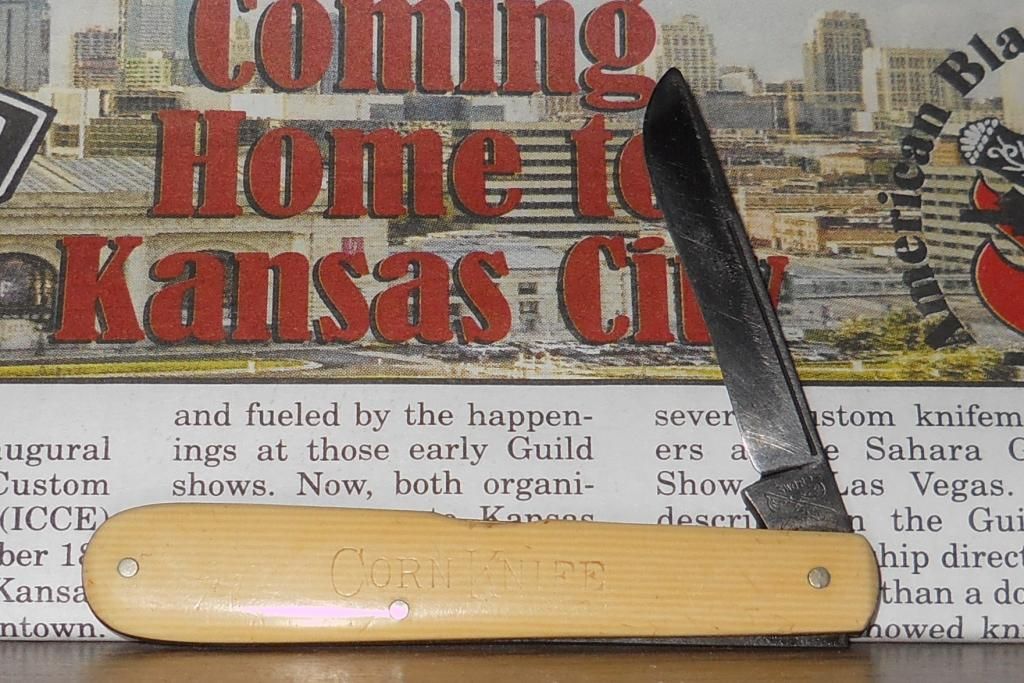

Here are my two, a Schrade Walden, and a long-pull Camillus:
Will we see this level of quality again, in a humble working knife?? Very nice knives, with ivory cell (french ivory?), and some sales numbers on the back. They came from that collection that A.G.Russell is selling.

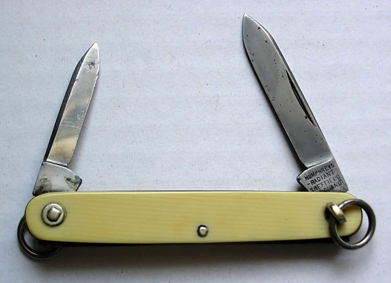

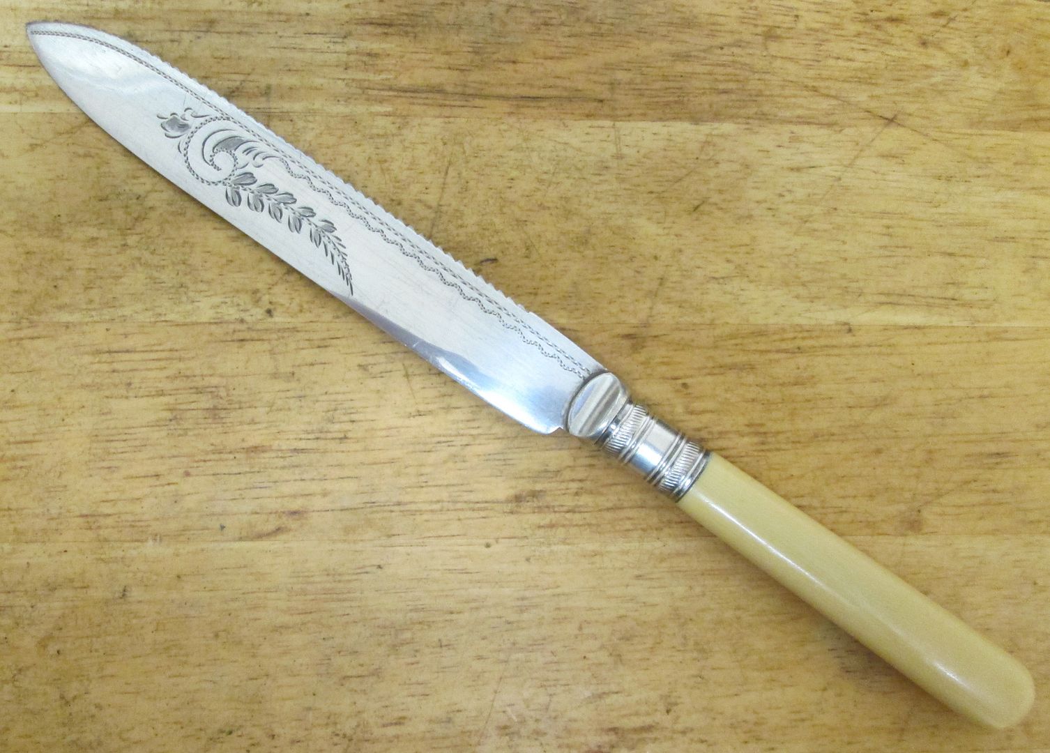

It was used extensively by Sheffield cutlers, for table cutlery as well as penknives, I have loads of the stuff. It can look good, but unlike the real thing, it shrinks slightly over time, which can lead to some ugly gaps at the bolsters. The product itself seems to vary, with the even grain of some being very obvious, and in other cases less so, as in this Sleeveboard by Joseph Rodgers for example.

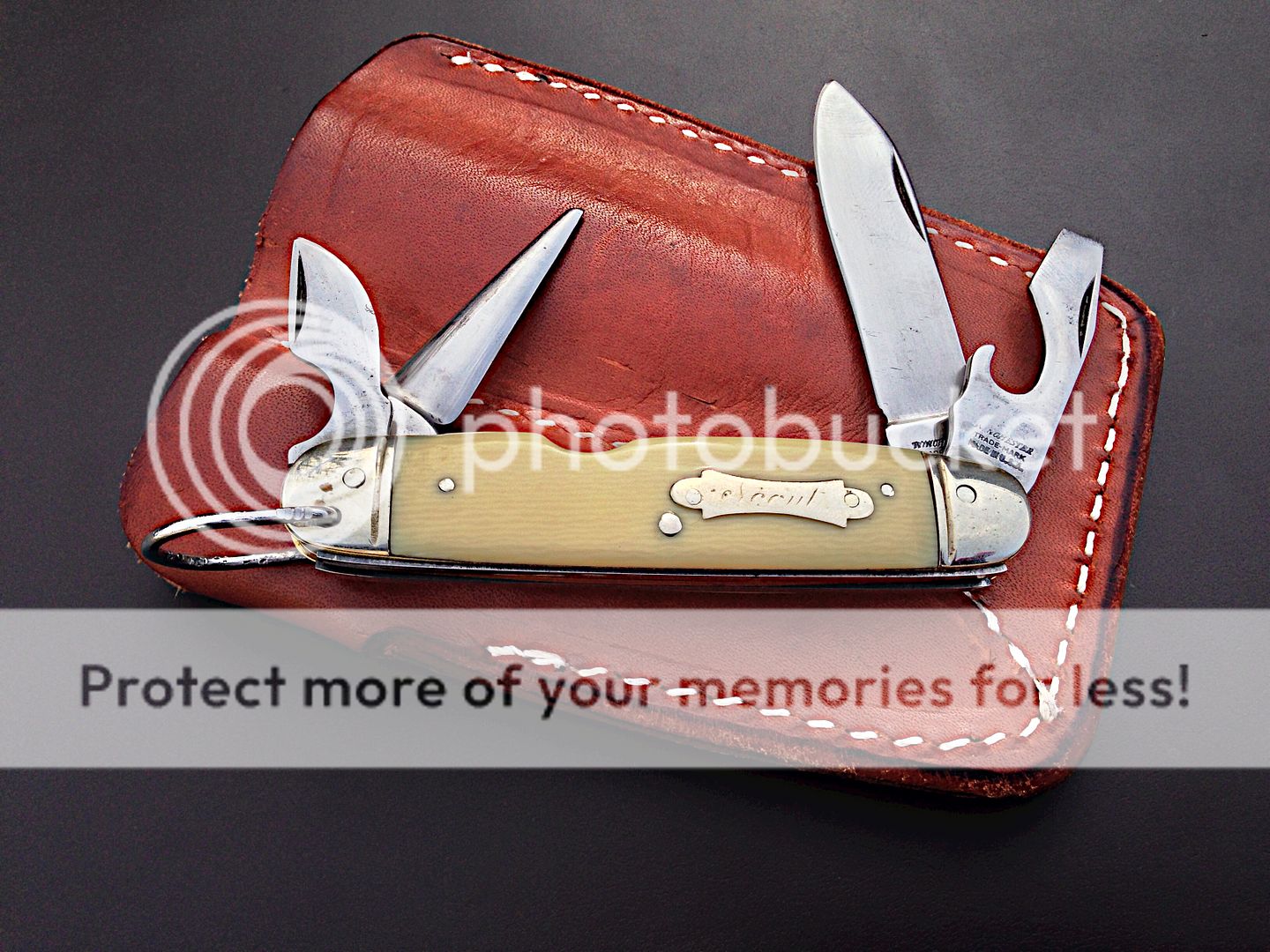

Here are the two I have. The FJ is a cut co, the 196 is a Walden NY USA, A very thoughtful gift from Scott, thanks brother.
Have a great Sunday folks.
