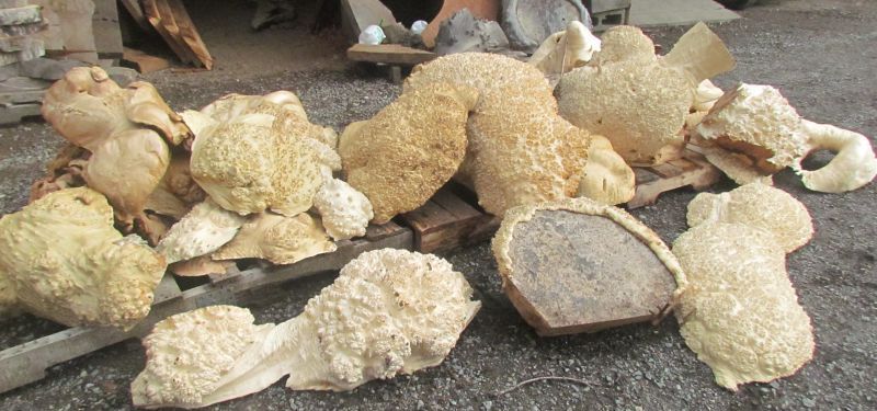

A quick note: this wood is not for sale. It will be quite a while before it is dry. Then off to K&G for stabilizing. Just wanted to show some photos of what I am up to. The dog was not really cutting the burl. She needs a lot more training before I am willing to let her cut the good stuff.
Winter time is usually when the burl hunters bring in burl.
Most of our burl comes from guys who work for tree services or are cutting firewood.

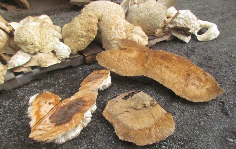

These just got pressure washed. They are mostly side burls that are sliced off the trunk like trimming away a branch.
Sometimes we get people bringing stuff that don't have a clue and butcher the trees. The 2 bottom pieces came from a property owner who butchered the wood. I wanted to pay him not to cut wood. Fortunately it was from trees on his own property and the rest was getting used for firewood. These 2 pieces were messed up for most uses but I will still be able to salvage some good handle blocks. The big one is going to yield a bunch of very good blocks. So next thing to do is cut these up into blocks and put them into the drying room.

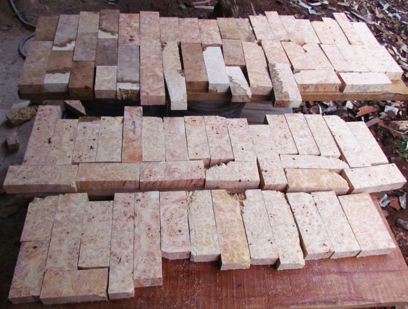

With most burl I like to work with the fresh, whole burl so I can have more control over the look.
I cut almost all of these so the faces of the blocks would be parallel to the outer surface of the burl.
This way of cutting produces a lot more waste but I think the look is more than worth the loss.
My thinking is that it is better to have a few really good looking pieces than several mediocre looking ones.

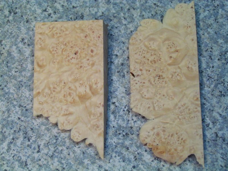

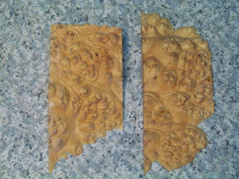

These photos give an idea of the look you get when the blocks are cut with the faces parallel to the outer surface of the burl.
This photo shows the outer surface. Note the pins and bubbled areas.
Now the cut surface. When cut parallel to the outer surface the figure looks very similar. The eyes are what we see as pins on the outer surface and the rounded shapes are the bubble like areas surrounding the pins.
If I was cutting blocks from pre-cut slabs or blocks like you get on ebay or specialty wood suppliers I would only get a couple if any with optimal burl figure like this. Too often they are cutting for volume because that is what makes the most sense from an accountant's point of view.
