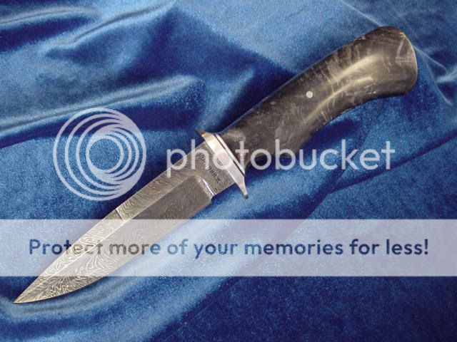

This is the frist try at making the feather damascus, I think it turned out well but will need a little tweeking
Blade is 1095 and 15N20 5" long and OAL is 9 3/4"
handle is stabilized and dyed Buckeye, 416 stainless guard.
comments welcome

Not sure, exactly, how much tweaking you "Think" it needs, my friend. That knife is gorgeous, and I don't even like the dyed burls, usually. :)

Thanks for the comments Danbo.

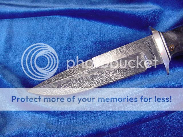

The tweaking I'm thinkin is that my spliter was too sharp and I didn't get as much crush effect as I was looking for.

Were it me, I would be very pleased with the steel, especially for your first. Very nice!
I can see what you mean on the crushing of the feather,though. I have been saying for some time that I need to make some feather pattern dies for my press. Question: How wide was the tip of your dies and what would you recommend for length & width on them? (I have an Uncle Al press.)

Very nice pattern Mike. Feather is my favorite.
I usually judge a feather pattern by how close the spine of the feather follows the center-line of the blade.
Nice blade profile as well.
Congrats.
Mike I think that is a nice looking feather if that is your first one your on fire
