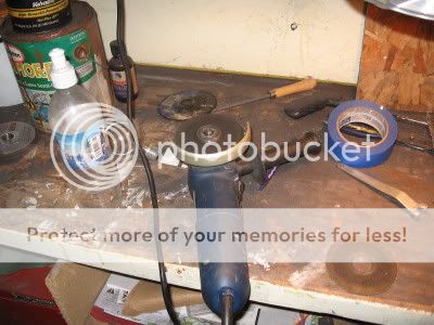

I wanted to try and make a couple of knives. These are my 4-5 attempt. Hope you enjoy.

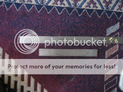

Drawn out on the O-1

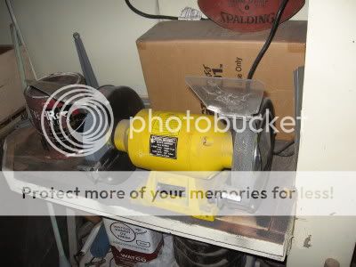

My high tech machines used.

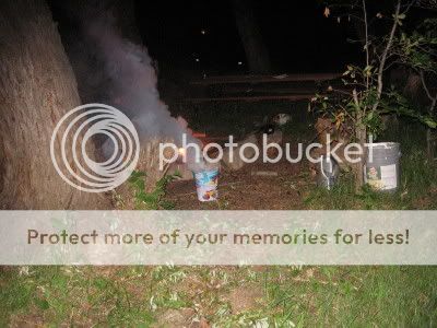

My primitive forge that was able to get the metal nonmagnetic. Coleman airbed pump for bellows.
Oil quenching, the flames had just died.

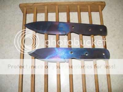

Post forging.
Post triple temper at temp for 57-59rc.

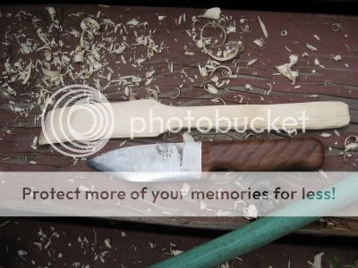

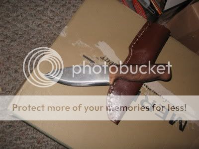

Thanks. The oak handles finished and review of performance coming.

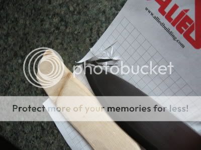

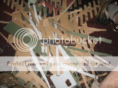

120 8-9" average cut length through cardboard.
edge test, still shaving heading outside.

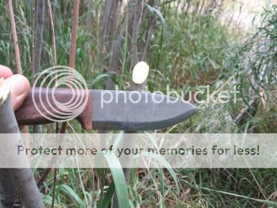

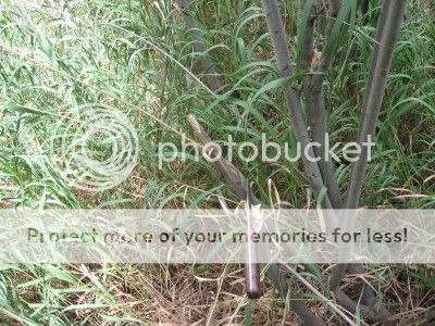

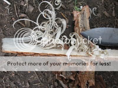

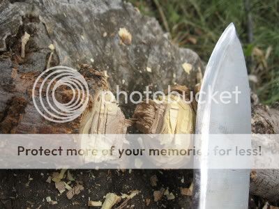

The knife snap cut through willow branchs more easily than bending the branch and push cutting.

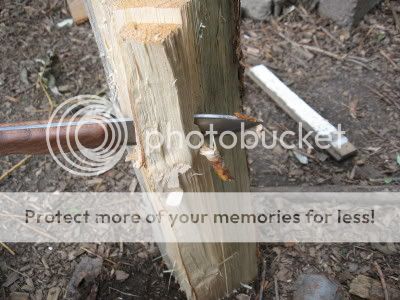

a little chopping
more to come.

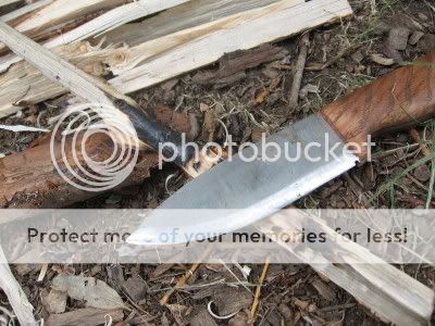

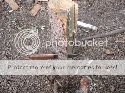

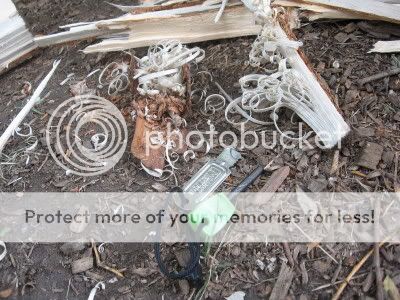

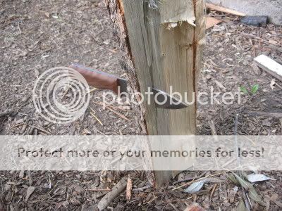

Onward. Let's batton.

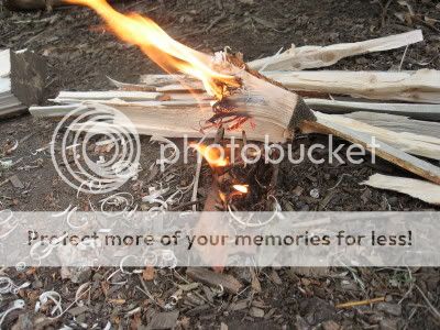

After creating some kindling, I made a quick fire.

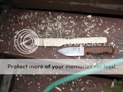

I had flame and let it die. Making a spatula next.

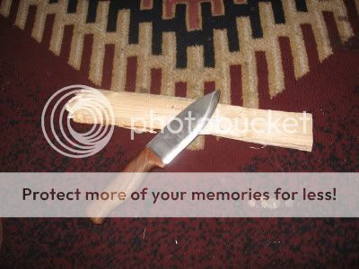

easily done.
another edge test after the woods work.

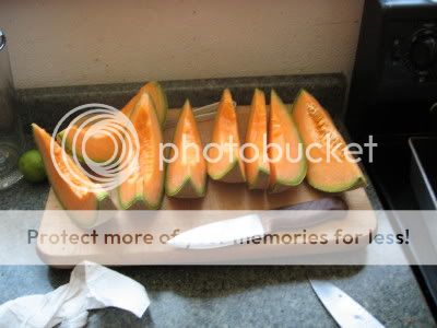

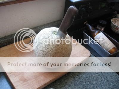

On to the kitchen.
She slices and cuts like a dream.
Yum. At no time during the test did I resharpen the knife. It would not shave hair at the end, but would still shave paper. I am very happy with these. Specs. 4.75" blade, 4.5" handle, 1/8" O-1, 1.5" blade height, convex ground. My new favorite bush crafter. Hope everyone enjoyed this.
