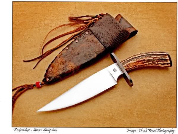

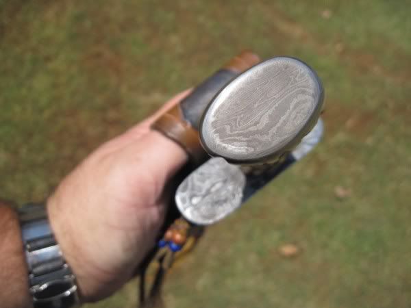

I'm not really sure what category this would fall into. I think it could go either way between fighter or bowie. I'm pretty happy with how it turned out. The knife is 3/16" D2 with Alabama damascus guard and pommel, stag handle with a mild steel pin. The sheath is deerskin rawhide wrapped over a veg. tanned liner and stitched with linen cord and the welt is held with the addition of cut copper tacks. It has a beaver tail leather throat and dyed veg. tanned leather belt loop. It also has buckskin fringe with copper cones, horsehair and brass and glass beads.
Critiques are welcomed.
Mr. Ward's photo is obviously much better than my own.

Thanks guys, this is one of those knives that I won't be too sad to keep if I don't find a buyer. I had Chuck Ward take a professional picture of this one. When I get it from him I'll try to post it here. I have no doubt that his pictures will be better than mine.
