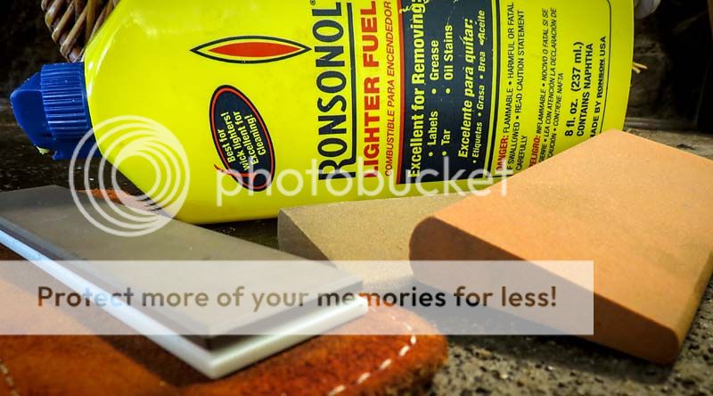

Stone in hand, I've recently moved to doing that lately, these couple of Norton slip stones work great, at 3 1/2" long they are small enough to carry to work or elsewhere, also have the Spyderco Double stuff, use the leather pouch as a makeshift strop if need be, but between these stones you can get a hair shaving edge pretty quickly.
A friend, Tim Wright, gave me a tip to use Lighter Fluid to clean the stones off, that works GREAT not something you'd always carry with you but you can keep some handy to clean out the steel grit. I use these stones dry, no oil, no mess...
