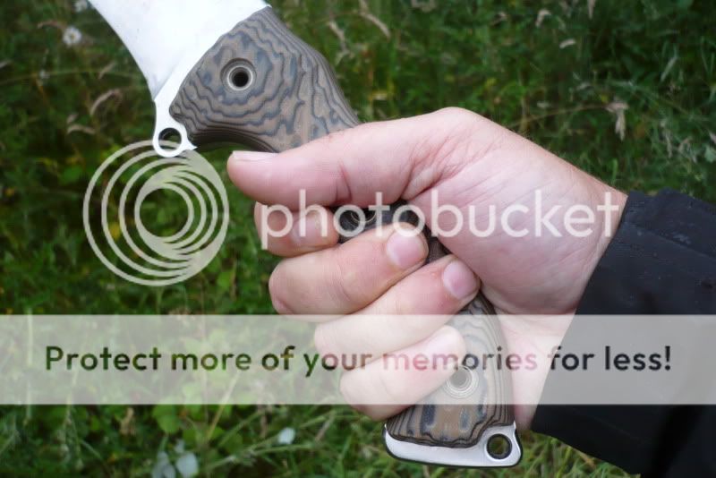

It's not just the handle material you have to take into account, it's also the handle texture. I've got a CGFBM that has G10 handles that have a heavier texture compared to some of the canvas micarta blades I own. I have to wear gloves to use this FBM because it almost hurts the hand to grip it. Or I could probably sand it but it's a FBM and not a daily user to me.
Black paper has finer texture to it then canvas micarta so without a rough texture finish it will probably seem slightly more slippery in hand compared to G10.

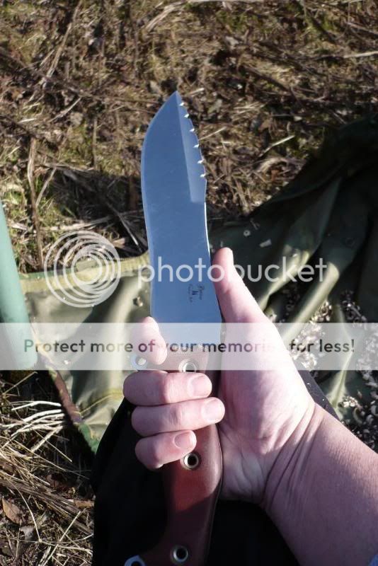

Smooth Magnum Hand Shaped grips of Linen Micarta are the best for comfort and grip when chopping. You never need to do anything with them.
They always feel good in hand ....
Smooth black paper feels more slicker in the hand but is still able to be gripped well for chopping .... very comfortable also ....
Machined G10 has always needed smoothing off a little on the pattern for me .... just a little to take away the harsh edges for comfort when chopping by hand .... the same is true for machined pattern linen micarta as well ....
My G10 TTKZ was smoothed out a little and can now chop for hours without any bother .... the machined black paper on my NTTKZ also needed a little smoothing but not much .... these too are now very comfortable ....
All told I think smooth linen micarta is probably the best ... then black paper .... smoothed out if there is a machined pattern you like or totally smooth if you prefer ... then G10 smoothed out if there is a pattern .... it depends on what you prefer though as they all have a "tactile" feel to them which is different and will appeal differently I expect to others .... for me I am happy with them all if they are smooth enough not to give hot spots .... but if you don't want to mess about .... factory hand shaped linen micarta grips work the best out of the box.
