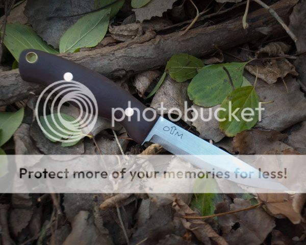

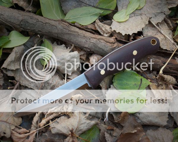

I have a knife design that has been rattling around in my head for some time. I have to admit, it is also not solely my brain child. The design also comes from months of chatting with Ben Piersma, owner of Ben's Backwoods.

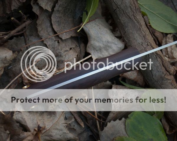

One of the most underrated knife features (in my opinion) is a swell on the top of the handle. When you close your hand around an object, having something filling in that space is pretty damn important to comfort. It is something that a simple oval shaped handle can do very easily, but becomes trickier with a full tang knife style like this one. It seems so many knives are cut out of a piece of stock that is flat across the spine and the back of the handle. While easy to do, it can never match the comfort level of a swell like this, in my opinion anyway.

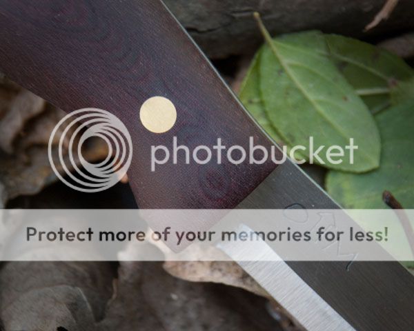

The second key feature on this new knife is the first finger groove and guard area. A true guard gets in the way when doing things like batoning notches on a flat surface (like a log). But, having a little bit of something there can be*beneficial*for the grip I am about to talk about.
Previously, one of my primary concerns with this area of the knife was to get the first finger groove as close to the cutting edge as possible. Easy to understand because it is a matter of leverage. The farther away from your hand the item you are cutting, the more leverage it has. Power cuts are done up close.

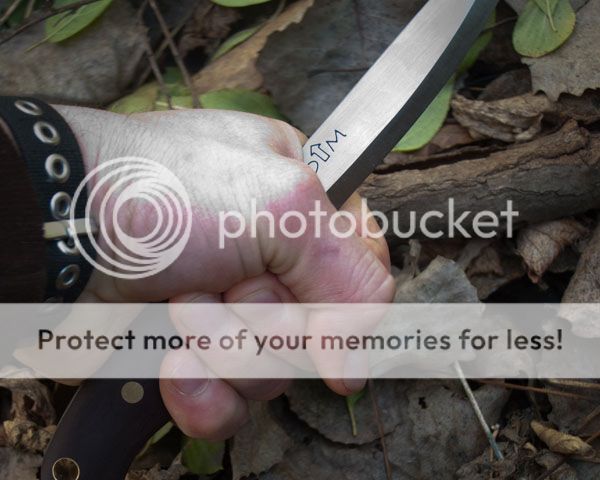

However, this one is a bit different. I put some space in there for a very good reason. Ben has been known to grip his mora's with his whole hand going over the guard. It kind of puts your first finger half over the cutting edge, but it is not scary to do. It feels like it centers the whole knife in your hand, and gives it a balance that is not achieved by simply "getting close to the edge." It allows a lot of control and makes doing things like feather sticks a really fun task. Since Ben grabbed his Mora's this why, I try to optimize this area of the knife specifically for that, and I have to say it feels wonderful.
The picture I have of my holding is attempting to show that grip. I was trying to take the picture with a big camera and no tripod so I had no choice but to do it up close and left handed.
I will try and get a better picture, but if you watch Ben's video on the Ghillie Kettle, right around 0:20*you uwill see him using this knife technique.

Looks great to me! The one thing I'd change personally would be to widen the blade, but that's my own personal preference. Looks like a true working tool. I like it! :cool::thumbup:
Looks nice to me. If you were to make it out of thinner stock and put a flat or convexed grind on there, it would make a dandy boning knife as well.
yep, all good points.
I don't do the hump, but instead a long curve on the spine. It's more comfortable to me than a straight spine.
Also, the front of the underside of the handle requires careful consideration so you can get close to the back of the edge without getting cut. I generally find choils on medium belt knives to be crutches for an under-designed handle.
That's not a fugly knife at all. Form follows function and it looks to be well-executed. The only thing I'd change stylistically is to give the front of the handles a bit of curve instead of a straight perpendicular to the spine.
Good looking knife Brian. I to have made a few knives with a handle spine swell. I find them pretty comfy in the hand like you said.

One, with regards to the swell on the side. You have to realize that feature on a handle would absolutely fill in your hand. You also have to realize though if pressure gets applied there or not. In your normal up/down motions that come from cutting, pressure does not get applied there (for me anyway). It would come from a side to side motion, which I don't do, so I decided that feature was not worth the trade off for me. Everything is a trade off, right? :)
Second, something that fits your hand may still need some tweaking once leverage is applied to the blade. When you put pressure on the blade, it tries to rotate the knife in your hand, which creates 2 critical areas. The first being where the spine hits the web of you hand between your thumb and the first finger. This one is the most obvious, and most people get it. If a knife is too narrow there, or has corners, it hurts your hand under pressure, and the knife gets sold. The second one is much more subtle. When the knife tries to rotate, it is also held in place by your pinky finger. Have the "shape" where your pinky wraps around the handle. This was taught to me by a friend who suffered a pinky injury and was much more sensitive to shape in that area to most. But, once he turned me on it, I realized how much of a comfort difference I could make by paying attention to that area.
