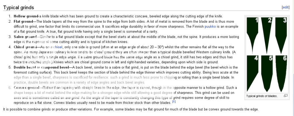

im new to this and i was wondering what exactly is the difference? why would one be better than the other? this may be a factor in the next knife i purchase

How about a full hollow grind? On a full flat grind the main bevels are ground flat from edge to spine( no parallel surface ) On a full hollow grind the main bevels are concave. The main bevels can not be labeled full flat or full hollow if their is any parallel surface, along the spine. Which ones better ? This arguement could go on for days. Personaly I have'nt found any thing a hollow grind can't do as long as the thickness is right for the job.

This might be of some help.

yeah thats a good diagram. i saw it on wikipedia. it helped a lot.
