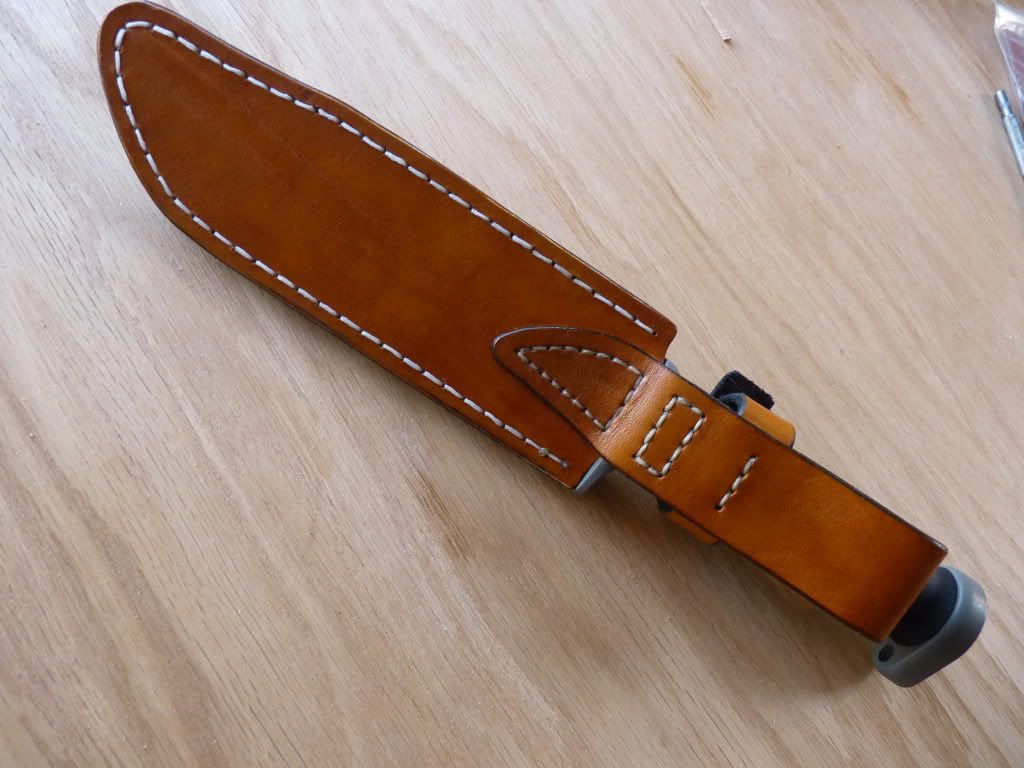

Full Size Kabar sheath

Tell me what you think.
It looks very nice. I don't know if you're looking for critiques, but I have one :D
It doesn't look like you put a groove for the stitching to sit in. It is something that I look for in a sheath because I think it helps to keep the stitching from getting snagged and pulled loose.
You do good work....But I can't help but wonder if the way you stitched the belt loop to the back panel will hold up in the long haul. That's a heavy duty working knife, I'm not so your belt loop method complements it that well....I guess only time will tell...but I like your craftsmanship.

I see. How would you suggest it be stitched?

Can't say about the belt loop, but listen to RB.
He knows his stuff.
I think it looks great, what type thread did you use?

I used "natural" linen on the belt loop. I intended to use that on the whole sheath but It just didn't look clean when I tried to stitch around the edge. I think it was because it was thicker then the nylon I usually use and I didn't make the holes any bigger. I used the nylon instead.
Just a suggestion....make the belt loop out of the back side panel......I recently made one....

I fully agree with Rayban (I usually do!) It seems that you are using what looks like four stitches to the inch. I would suggest going to five or six both for appearance and the fact that it will make a tighter loop. You are to be complimented on the overall construction.-----Sandy

Yes I use fewer stitches on larger sheaths because I believe it looks nicer. It looks oddball to me for a large sheath to have small stitches. Thanks.

Looks real good Jiggy. I too have a suggestion FWIW. I am finding that I very much like the look the black thread on a sheath that color. I too did most of mine with a tan braided linen. Then I got a wild hair and I did one with black. WOW, it really popped for me and yet was not garish. So that's my new thing, natural color with black thread and, if needed, peened copper.
