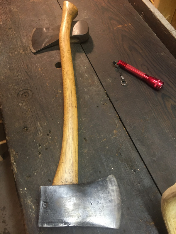

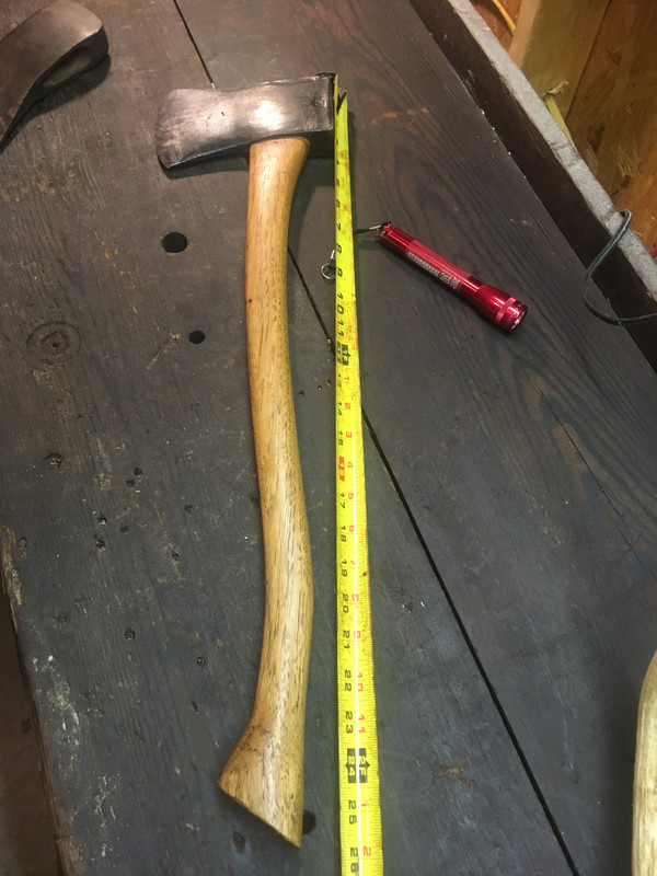

I apologize I thought it was 24” but it’s 26”. It is too short to split firewood like peg said it is in the shin zone. Handy size for a lot of things though. Would you guys say this is a Dayton or Connecticut? Also I have no clue of the maker stamp.
Thanks guys! good to know that 20-24" may not be that useful for a full sized axe. That's why I asked.
Pictures can be super deceiving - a head can look totally different depending on the angle. Can you list the weight and dimensions? poll,bit, and total length. I usually think of the length to width ratio of a connecticut pattern being close to .7, whereas a dayton or michigan is usually less than that. For a 3-3.5lb axe a connie will be something like ≤7" long x ≥5" wide at the bit, whereas a dayton or michigan will be more like 7.5" long x ≤4.75" wide.
