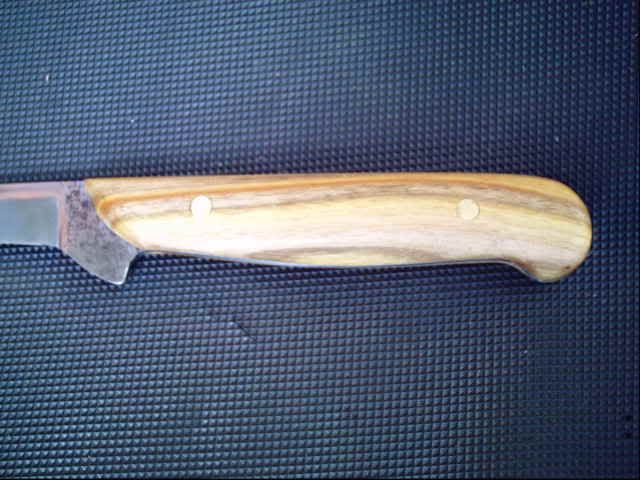

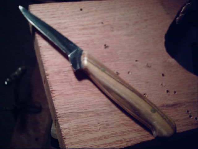

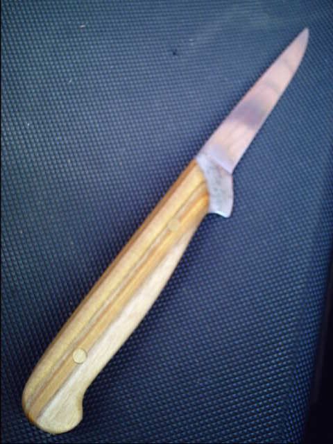

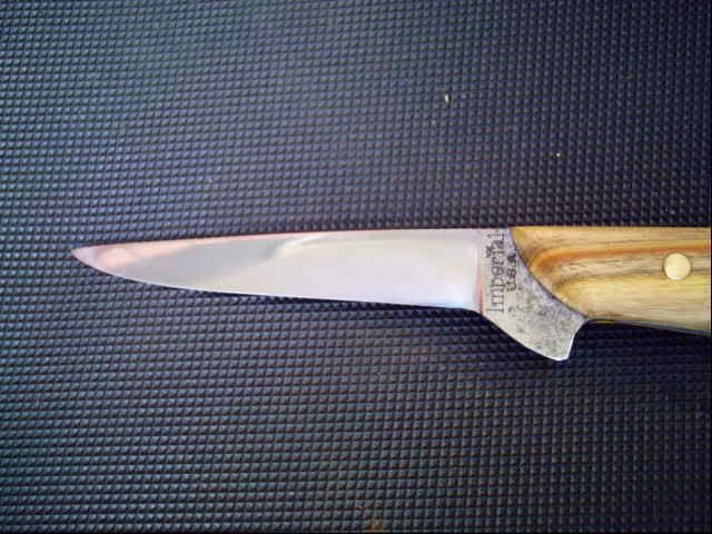

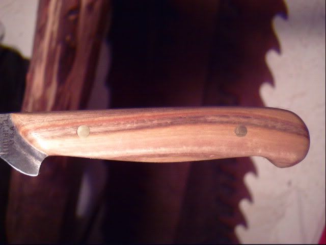

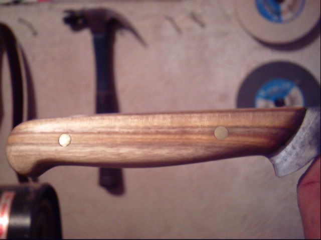

Had an imperial blank I had started on a long time ago, figured it was time to finish it up. It was saber ground and had a real curvy clip, I flat ground it, lengthend the grind line, threw on some staghorn sumac scales, straightened the spine out and shortened and rounded the integeral guard a bit. I wanted large "pins", but figured this would be a great opportunity to try out some of the cutlers rivits that good ol' Dale sent me (thanks again man), worked like a charm. Not near as hectic as I thought working with the rivits would be, not a problem at all really, not much change in the routine, other than inletting the handles for the heads. Anyway here are the poor quality pics:

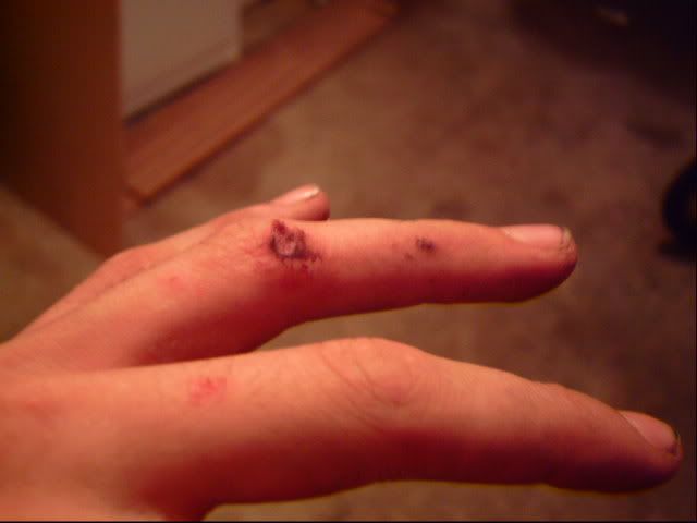

P.S I'll learn to keep my fingers away from the sander.....eventually.
Yeowch! over one square 1/4 inch of skin<:-(
Hey MM,
Great work as usual.............the knife that is, not the finger.:eek:
I am glad the rivets worked. Jantz sells rivet drills to counter sink the rivet heads. A bit pricey ($25) but they keep me from messing up a lot of wood. :D
Keep up the great work, and keep your fingers clear of the machinery.;)
Dont feel too bad though, I buried a Dremel bit into the base of my thumb when working on those knives for LT.
There is a great thread in Knife Network about "What's Your Percentage?" It is a discussion by knife makers about how often they bleed when making knives. Many have a 100% rate, ie; they bleed with every knife they make.
