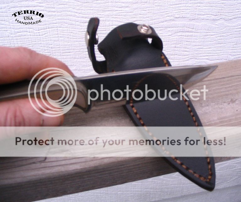

I made myself a new EDC a few weeks ago, in CPM-3V at 59Rc. To find out if/how badly this stuff really rusts, I left it with a very basic belt finish. It has not been etched or passivated at all. We've been using it daily in the kitchen for the last month, with strict instructions to NOT clean it after use, DO leave it lay around wet, etc.. Here's what happened:
A bit rough, but not as bad as I thought. The orange spots could actually be mostly scraped off with my fingernail; a few passes on a clean A16 Trizact belt cleaned 'er right up. There is a tiny amount of tiny dark pits where some of the orange blossoming was.
All in all, I'm pretty pleased! For a steel with only 7.5% chromium, I expected a lot worse. I'm pretty sure that small of an amount is almost entirely tied up in carbides. I'll be carrying this one all summer with bare minimum cleaning and maintenance, to continue monitoring the corrosion-resistance and edge-holding (which so far has been outstanding).
Thanks for looking!

I want to make it clear that I'm abusing this knife strictly for my own testing!* The point of this exercise is to give rust every chance, to see what happens in a worst-case scenario. Normally I take my blades to a much higher finish, keep them clean, and in some cases, passivate/blue/patina them. All of these steps make the most of any steel's corrosion-resistance.
*I don't think I'll purposely break this one, though. I like it too much :)
