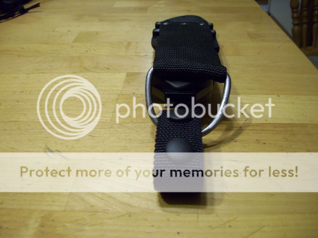

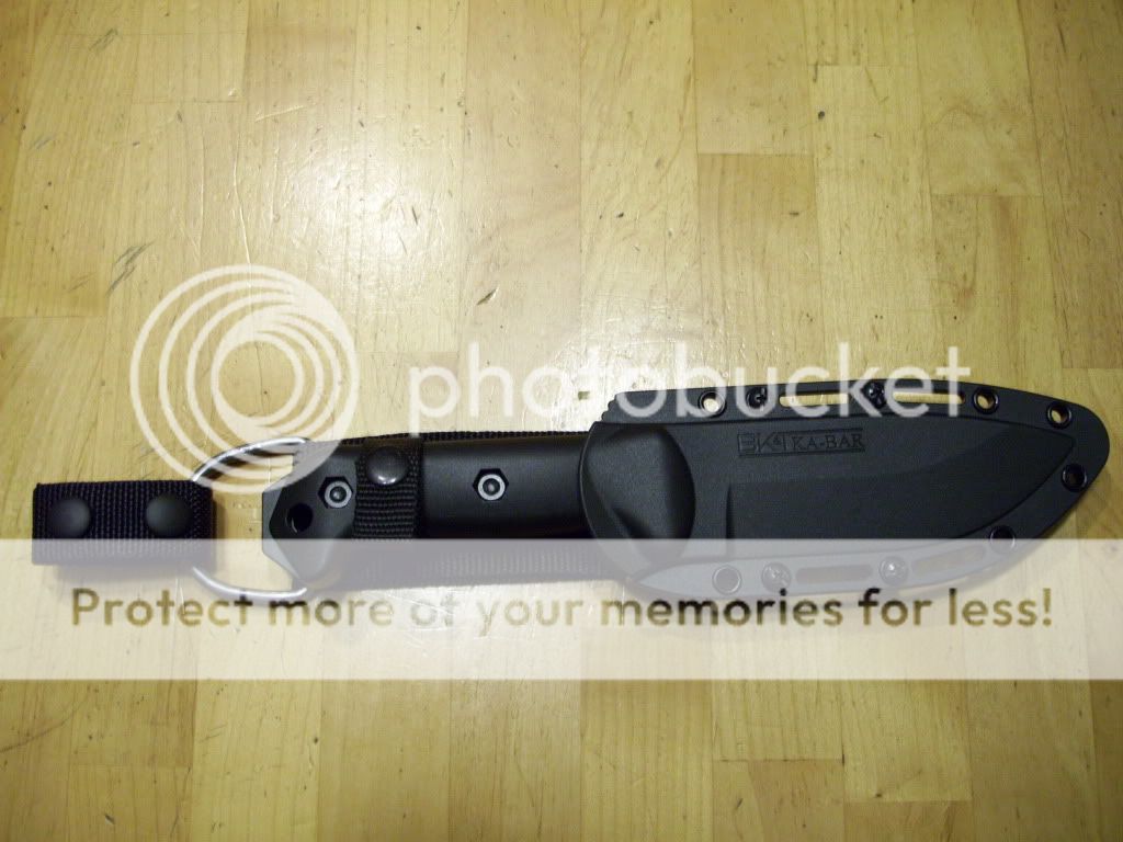

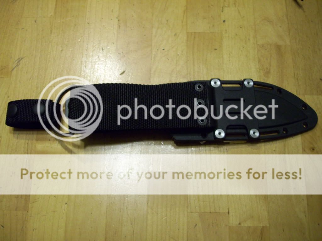

Simple, yes. HIGHLY effective, yes. There were no D-rings this big at the hardware store, so i bought some steel rod & cut & bent my own. This thing ROCKS now. You can get into/out of vehicles & atv's & squat down with NO BINDING or sticking the handle into your side when it is strapped to your leg. Hardly even know your carrying it now. :thumbup:
Is the belt loop made from a duty belt keeper? I like this mod a lot. I think that I may be able to scrounge a large D ring from an old Blackhawk duffle that I don't use anymore. Good idea.
Yes. It's a duty belt keeper. My original prototypes were sewn on loops. I used some HD 1" nylon stap material. I bought a HD dog leash that was triple layer, & just cut the thread so it was one long piece. Sewed it with 15lb test fishing line. Not pretty, but very functional. You can also adjust the length by doing it that way. So if your knife is long or short, you can have it rest in the same spot on your leg, with NO BINDING during any activity.
I would stay away from a duffle bag D-ring. Many are made from white metal & break easily. That steel rod is NOT going to break---ever.
