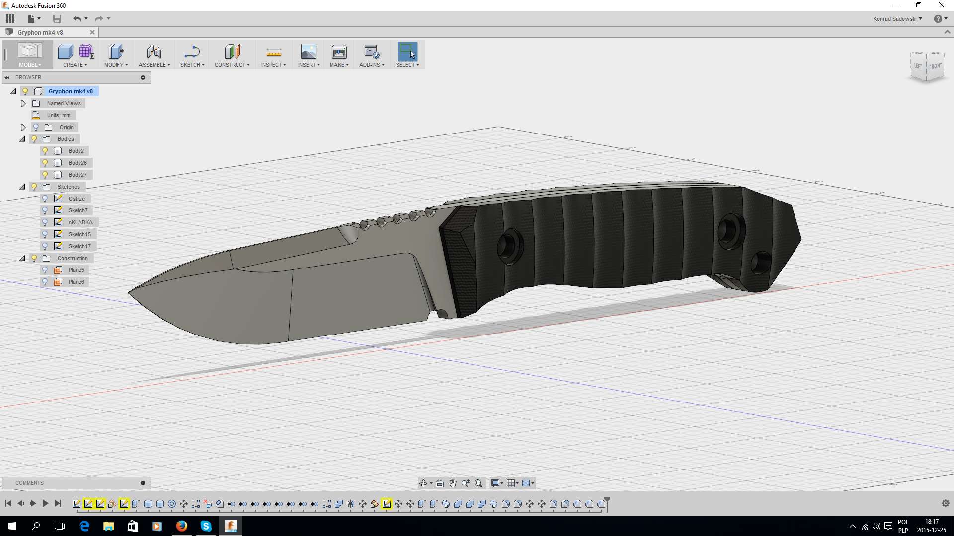

Hello everyone,
As my new PC can handle finally a 3d CAD program and Fusion360 is Free for small users...
I think to design knives in this software, and later folder knives.
For me it's good to see my design in 3d, not only a liner on paper...

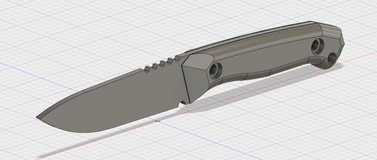

Here is the Gryphon Mk4 ( don't look at scales they are horrible xD ) but I have big problem in making bevel...

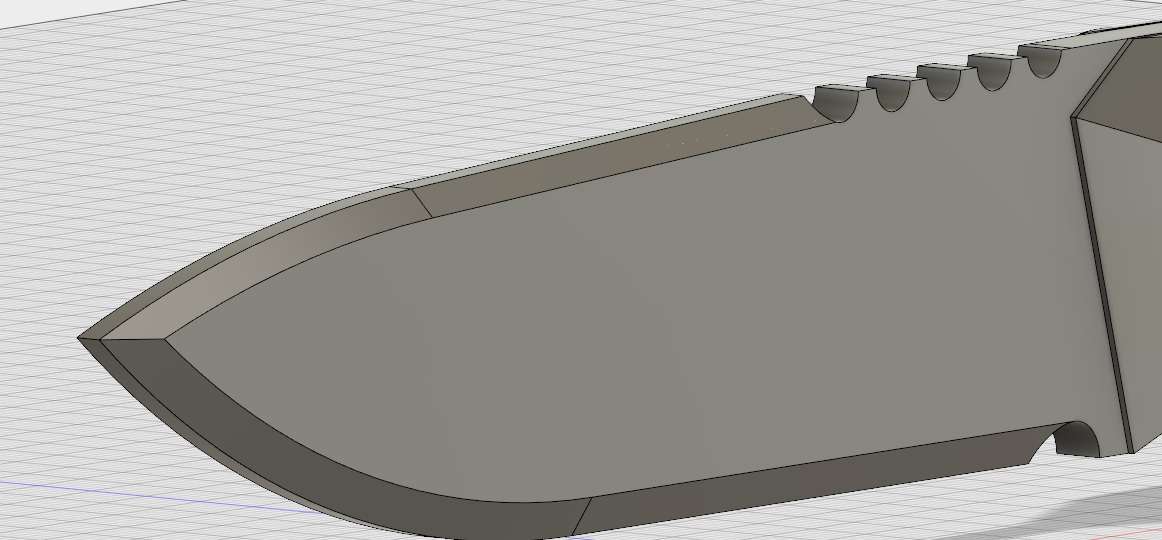

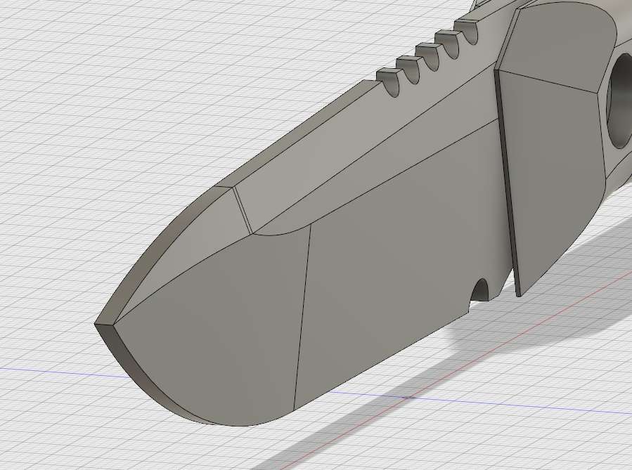

Logically I use for this a chamfer tool, but there is a problem.
Bevel is made ok before you overpass height of notch / jimping on blade, then this ugly Fusion make chamfer on the whole lenght of knife ;_;
Somebody know how to limit chamfer just to blade bevel ?
I have never used 360 to draw knives. In my career as a machinist I got a lot of experance with solid works and that's what I use. It really helps potential customers see there idea come to life. How I do edge bevels is draw the shape of the edge bevel on the plane that's perpendicular to the blade. I then move this to be where I want the edge bevel to start and then do a sweep cut using the edge as the swearing curve.
