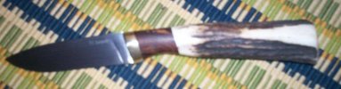

This is a knife I just finished up for my future mother in law, they do Rendevous and she mentioned needing a knife since her husband traded her other knife away for some period clothing lol
1084, differentially heat treated. Brass ferrule/guard, cocobolo spacer with a red stag tine I had laying about. 1/8" at the ricasso, 7 1/4" overall with a 3" blade. The blade is hand rubbed to 1000x then brought back to 600x.
Any comments or criticisms are welcome. Thanks for looking.

Will,
That is a pretty good looking knife (I think:D).
Do yourself a favor........ You obviously spend lots of time and effort on your knives, but it is hard for us to tell much with the photos.
Take a little break and get to know your camera a little better. Will, I'm not knockin' ya, I'm just offering a little "Free" advice.
If you can ever make the trip north to the Oxford/Anniston area, drop by and we will talk knives and "PHOTOS".
Keep up the good work my man........... Robert
