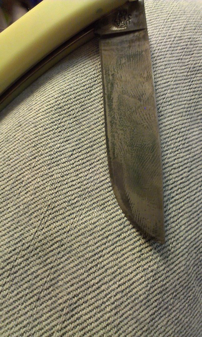

So I decided to dye my Sodbuster green. I *think* that the handle material is Delrin, but I've never had Delrin resist a dye job so tenaciously before.
Anyway, if you didn't already know, the handle on a Case Sodbuster is permanently attached. My usual mix of dye includes vinegar and being that the blade is carbon steel I knew that it would patina.
Before the bath I cleaned the Delrin really well, but didn't give thought to cleaning the blade.
This is what it came out looking like.
Not only are my finger prints etched onto the blade, they're green, and they won't come off.
I'm calling this the "Biometric Patina" :D
I've heard that the copper in brass alloy can 'leech' (no, 'leach') into adjacent materials, when exposed to acidic conditions. This is what causes so-called 'verdigris' staining (green oxide or whatever it is) on knives stored too long in leather sheaths (acids used in tanning are the culprit). Being that your fingerprints are etched in green, it makes me wonder if some of that has taken place.
At any rate, if you want to remove them, some wet/dry sandpaper will take care of it, I'm sure. :)

Well the pivot, or pivot caps or whatever those are appear to be brass. Wonder if they played a part...
Good one P. Thankfully I'm a perfect little angel so no worries there! :D
Yeah I'm leaving them. They actually look really cool in person. :)
Leeching would be the wrong term.
Galvanic exchange is probably more correct.
In an acidic solution, metal ions from all the reactive metals are dissolved into solution.
If the item is left in the solution, & the solution not flushed or renewed, the acidity decreases, an equilibrium is reached, & the metal ions start depositing out of solution. But they don't go back where they came from.
In this example, copper is the least reactive metal out off iron, zinc & copper, so it will be thee first to start depositing out of solution.

The brass liners & pins may be contributing also. In fact, on traditional knives, verdigris is often found around the brass pins attaching the covers to the scales (liners).

That's likely more accurate, thanks for that.
I think 'leaching' was the term I would've intended to use, in a very generic sense only. Different spelling & definition than what I posted above, and defined to describe how something tends to move/migrate/percolate through another material (often in liquid solution), and ending up in places where it wasn't intended to be.
