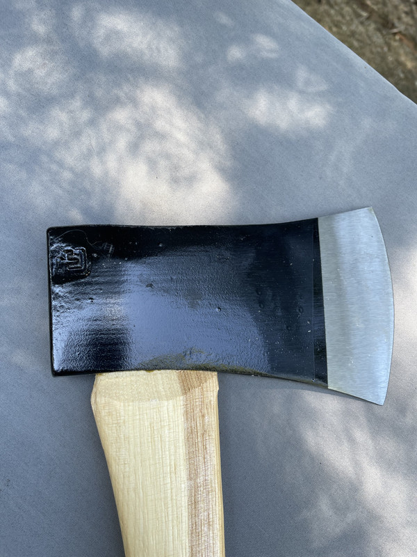

A seller on the bay has a bunch of these for sale. must be new old stock? hopefully they are legit? Seems like the FSS version was 1080 steel?
I know Whiskey River had a run made at one point.
Right. 1080 steel.

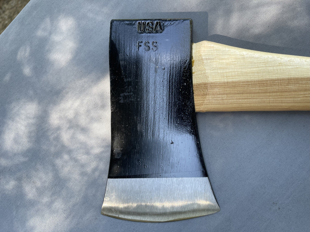

But I don't see any FSS stamp in that bay ad. Looks like just a standard boys axe. The Council re-issue FSS boys axes were clearly stamped FSS, even those from Whiskey River. I have 2 of them.

5 or 6 images down shows the FSS stamp. I don't have mine nearby to compare. Mine was from the second run WR did.
Price is pretty good if they are legit.

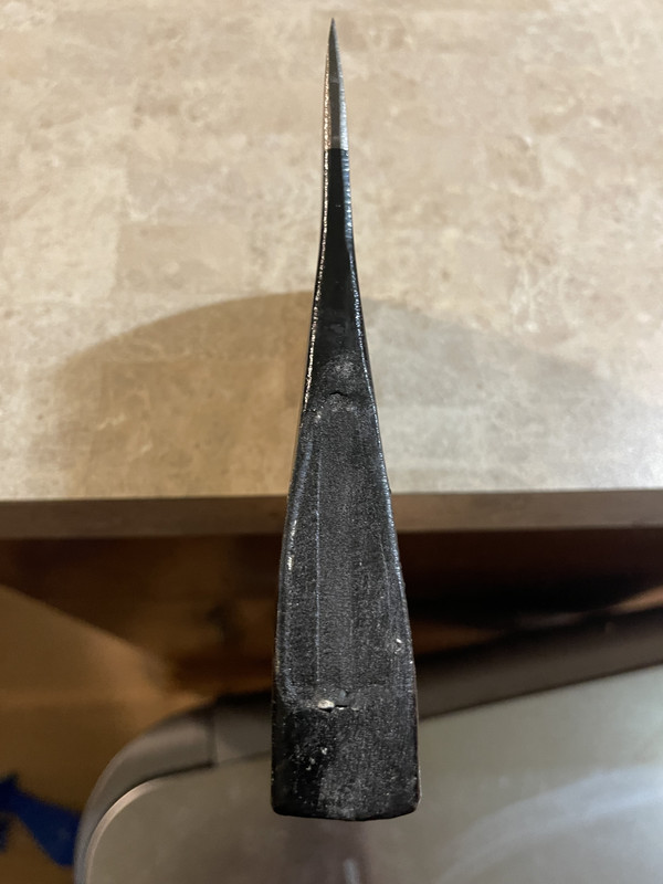

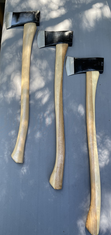

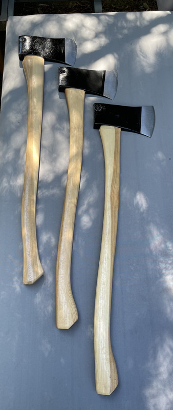

The handles are.. odd. The first one on the left looks like a typical Council Tool handle from the era. The other two look like B grade hardware store replacements. Can we get a shot of the wedges?
I will say Council has gone through periods in the past where sourcing sufficient handle quantities was a challenge and they used mixed sources.
That would make sense here. The FS wasn't too concerned about handle quality or grain orientation as I remember. I may have that wrong though.
S Skweeker
All 3 look like this.
Thank you. If those are plastic wedges then they're probably legit. Looks like it from the pic. I pulled the trigger on a spare or gift to a friend.
