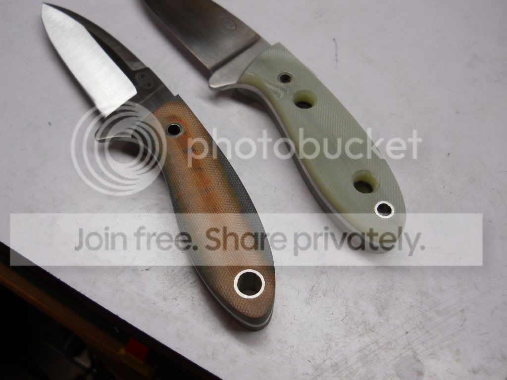

I was working on the handles of a couple of knives today and for some reason it just seemed like everything in the shop was getting an extra heavy coating of G-10 dust on it. My dust collection isn't the most high tech but it's what I can afford right now. I have a shop vac hooked up to my spindle sander and 1 x 42 that works fairly well for handle shaping collection, but there are times when I need to use my KMG on G-10, and the dust is EVERYWHERE!
I always use a good respirator, but just because the machines get turned off doesn't mean the stuff isn't still all over the place, and when the rest of the family goes through the garage when I'm not working, I don't want them breathing the stuff in. I've tried different methods of cleaning it up, including using the shop vac with a brush attachment, wiping it off of the bench and tools with a damp paper towel so that it sticks rather than floats away into the room......
If you care to share, let me know how you guys get rid of the dust. Even with more expensive dust collection systems, I'm sure there can be a thin layer of the stuff coating stuff in the shop. How best to remove it?
