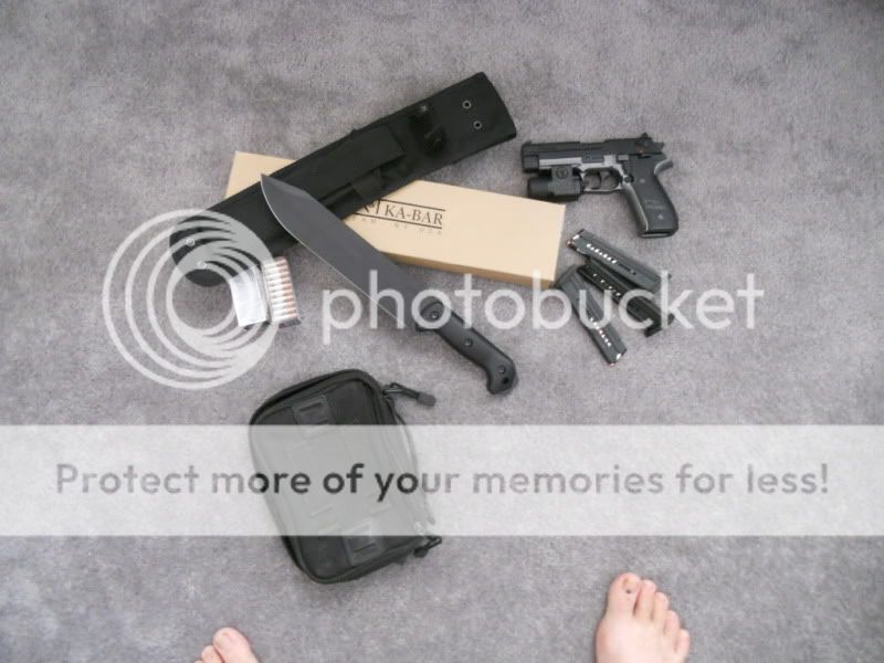

thanks guys ... here is a quick pic.. total stock, stripping will be in order and just a little
file work to make it fire steel capable :-)
sig mosquito for size , ( well and the toes on a size 12 foot :-)
I'm kinda looking for something stock size, no need for space under the scales.

During the last year, I have made my share of Becker scales. I have also used and closely examined samples from just about every commercial supplier I am aware of. Here is a set of mine-
The only guy I know that does commercially available factory type bolt on Becker scales iin G-10 is Saint Cutlery. He lists stuff on a large online auction site. His G-10 scales are $50 per set. His scales use factory hardware. G-10 scales are expensive due to the cost of the material and the cost to work it. It dulls the crap out of carbide cutters and the sanding dust is dangerous to inhale(fiberglass).
Saint's work is not exactly perfect since like many makers of stock removal made Becker grips ( both Wood and plastic) he does not mill them but shapes them into "sort of" Becker grips with a Belt sander. Yes, they are close but they are NOT the same side contours as the molded Becker grips. So it's a crap shoot. You may like them just fine, but they will not feel identical to Ethan's originals.
Having said that- pretty much ALL custom Becker grips are hand finished on some way and none of them ( Including mine) will be exactly like the Grivory ones from a mold. But some are closer than others.
I have the patterns to mill pretty much exact copies. My issue with doing anything in G-10 is the tooling wear and expense of the material.
If you are going to go to the expnse to install G-10 on your Becker, I HIGHLY recommend doing what I am going to do with my own hard use Beckers . Starting with STRIPPED BLADES- permanently install G-10 scales using , Accrglass Epoxy and and Stainless or aluminum Corby shouldered bolts- just like a High end custom knife. No dinking around with loosened bolts and shifting grips. IMHO that is the best way to put G-10 on a Becker. Tough and Bullet proof .
If you want the "Black blade" look you can always go back over the stripped blade with multiple coats of Radio Shack Etchant and get a very nice looking Black tactical look that unlike paint, you can always touch back up when it wears off.

I love G10 as a handle, but hate making it into one for the reasons mentioned above.
The wear on tooling and the awful dust are just miserable.
If I were doing becker handles I'd bolt 'em on, but I suppose that's a matter of taste.

I hear you on the removable bolt on scales, especially if one has not committed fully to a color or grip material or even the knife itself.
The bolt on scales allow you to simply take 'em of and switch them to another knife ,sell them ,whatever.. In my case I have about 6 Beckers that I have used and pondered long enough that I've made some firm decisions about what I want them to look like so I am ready to take that leap.
The OP may not be at that point yet with his BK9 but frankly I think Tigerstripe G-10 on a 9 will look good now or 10 years from now. If the scales are well done, the knife should be a joy forever.:thumbup:

Yeah, it's tough stuff to work with unless you have just the right equipment. It sure is not as tractable as wood or even most Micartas.

Saint will do as good of a job as he is able to given the equipment he uses. That's all you can ask of a craftsman, really. Be patent with him though, as like all of us he gets backed up from time to time with orders.
