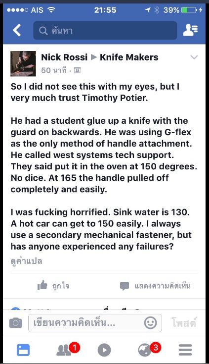

According to Nick Rossi post in knifemakers group on facebook. What do you guy think?
That's lower temperature than I would have assumed.
