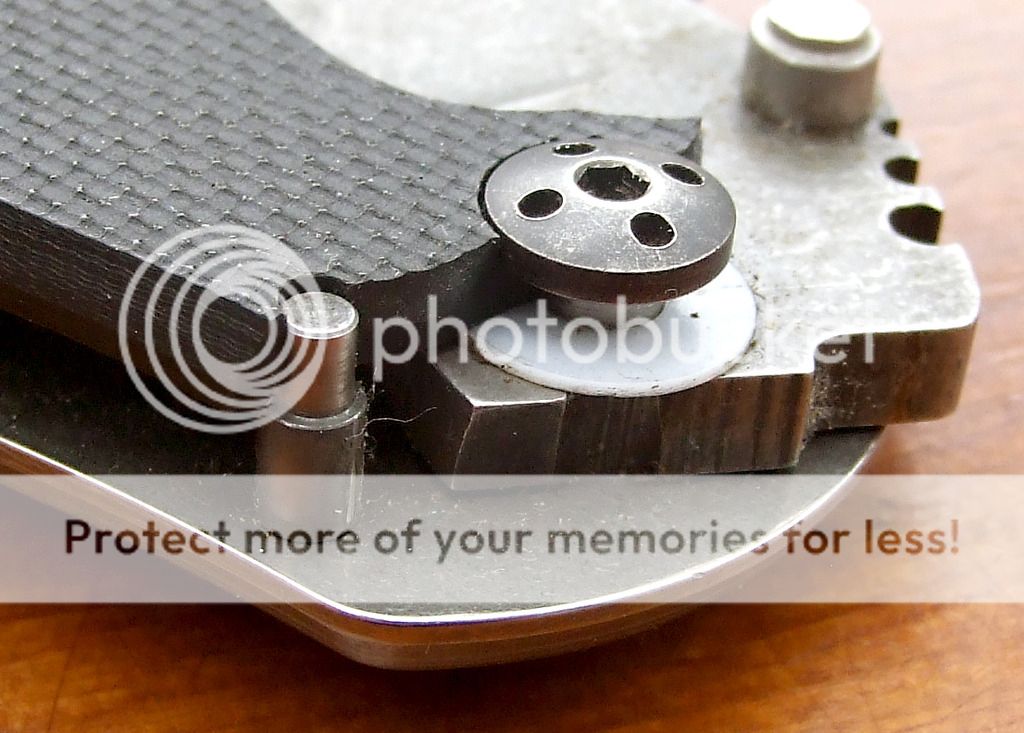

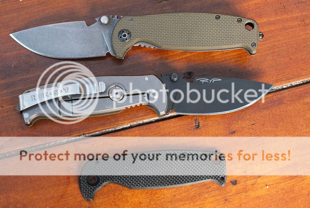

One of my favorite folders, a DPX HST, has it's G10 scale broken.
This knife has never seen any real hard use...while chopping/cutting a walkingstick from a branch of beechwood about 1 inch thick the G10 broke around the pivot.

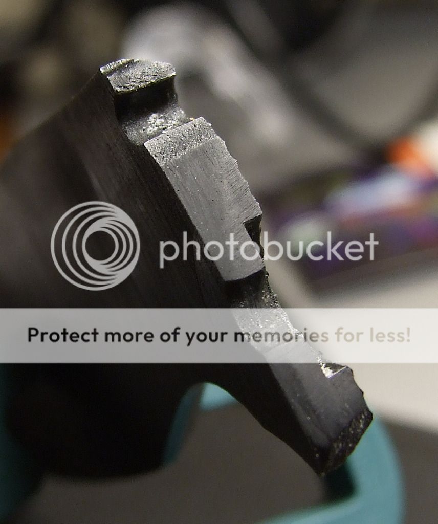

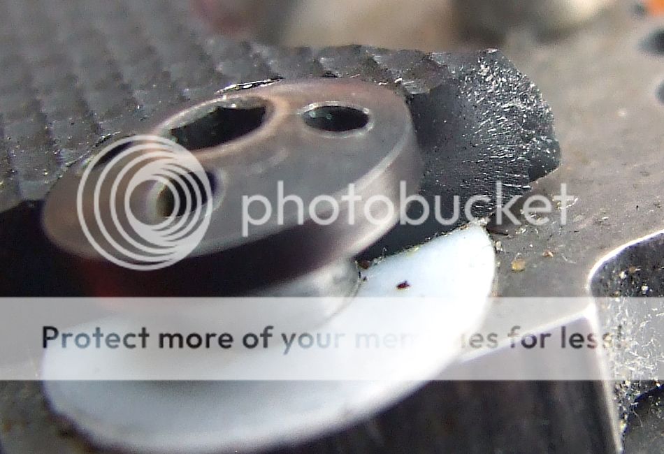

The surface of the broken G10 looked like this..

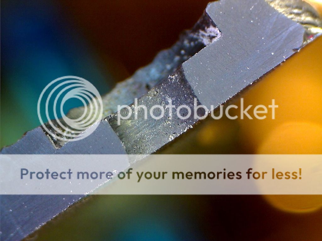

After sanding the surface looked like this.

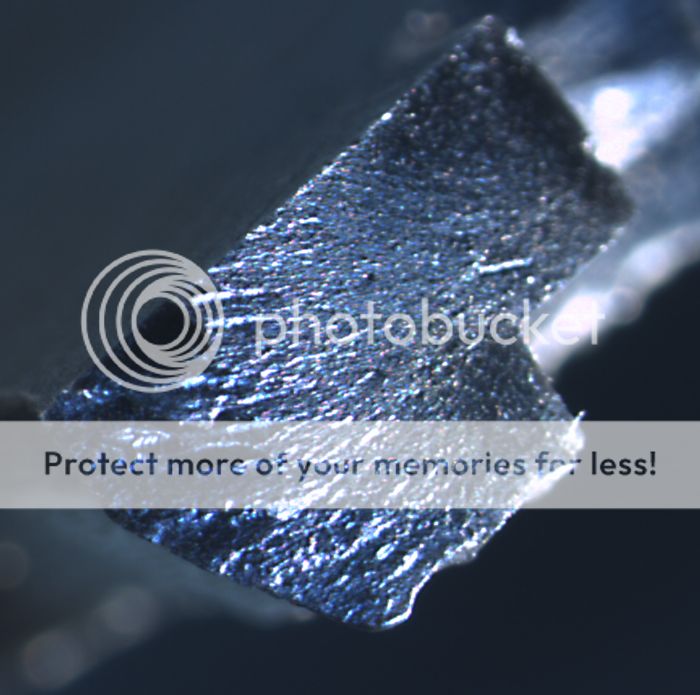

I believe G10 is some kind of laminate?

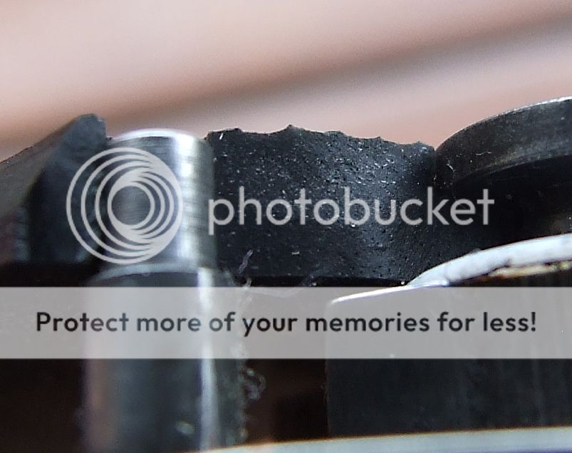

In my G10 I can't see any laminations...looks more like tarmac to me...with very tiny holes (bubbles?)
Especially the radial fissures near the pivot-hole looks very weird to me.
Can some-one shine a light on this?
Thanks,
Jan

We have produced tens of thousands of pieces with this construction. Never happened a problem of this type. Maybe there was a micro crack within the material G10. When I have the knife in hand, we will study the issue.

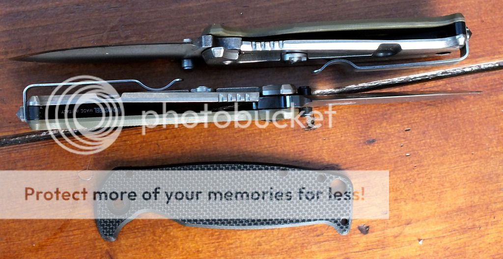

Today the postman came and handed me a carton box, all the way from Italy.
There they were..my beloved HEST's.
Perfectly serviced.......
New green scale and an extra black scale.
New Rotoblock instead of the shell-bottom.
Both knives perfectly adjusted and centered.
Both knives sharpened.
They both felt as new!! :)
All at no extra charge.
