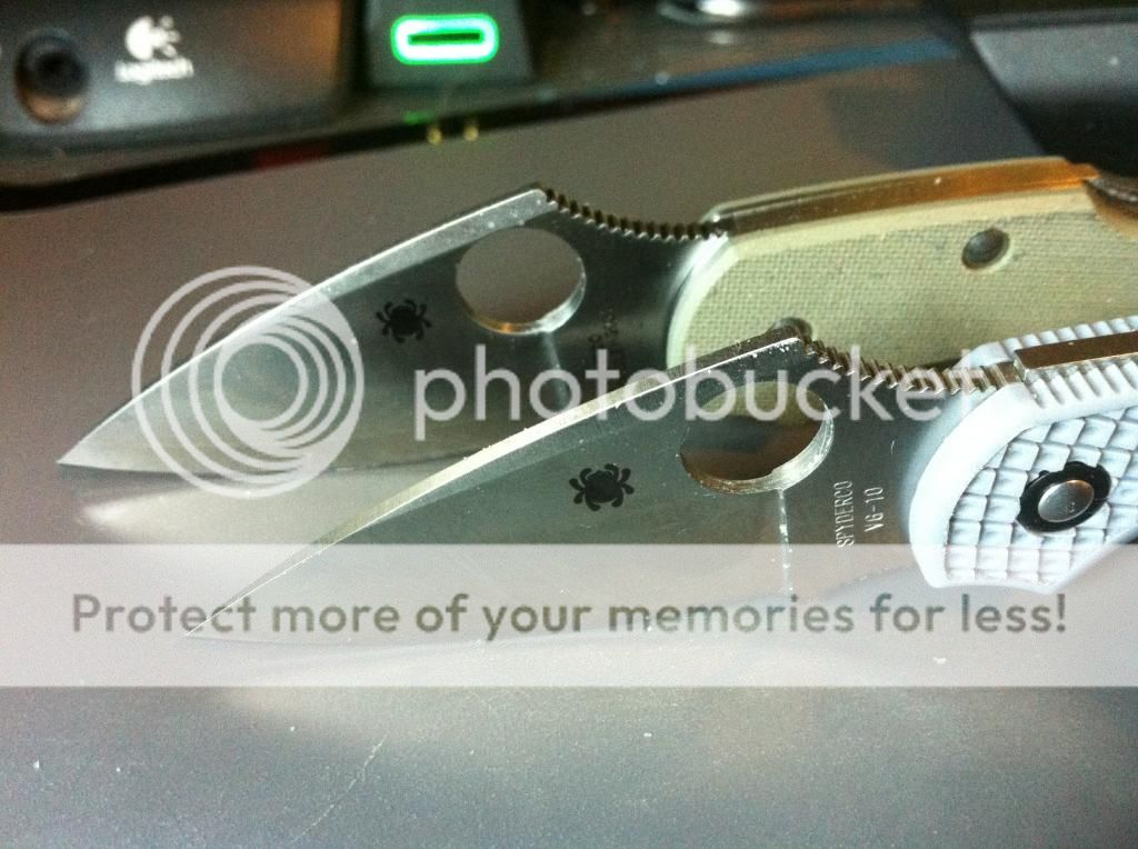

My question is "Can i swop round the VG10 blade for the ZDP189 to make a great little EDC perfect.
Thanks in advance for any advice.
Bob.
PS. I am awaitng the arrival of my new G10 DF.
I remember someone had posted before that this could be done and suggested that the blade should be swapped together with the lock bar.
Here's a vid that should help you...
[video=youtube;dSegyzbvq18]https://www.youtube.com/watch?v=dSegyzbvq18[/video]
Yes. You may or may not need to swap the lockbars. I swapped a SB blade with the VG10 blade from a G10 Dragonfly. The lockbar sits way high on the VG10 blade in the SB handle, but the G10 version is almost perfect so I left the lockbars as they are (The SB handle contains a spare blade for my orange LW as far as I'm concerned now so it doesn't bother me at all).
