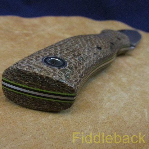

Yes! Burlap micarta from Shadetree is VERY light compared to g10 or micarta. In addition it is very grippy when wet. And lastly, on knives that I have gotten back for the cleanup and sharpen service, it has held up very well, and is not prone to shrinking. Shadetree uses a very good clear EPOXY! It is not a polyester resin. Its the best.
