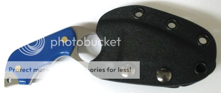

Fine grit sanding, think automotive or fine steel wool followed by some polishing will give you a shiny surface.
800, 1200, 2000 grits and Flitz polish on cotton cloth.
