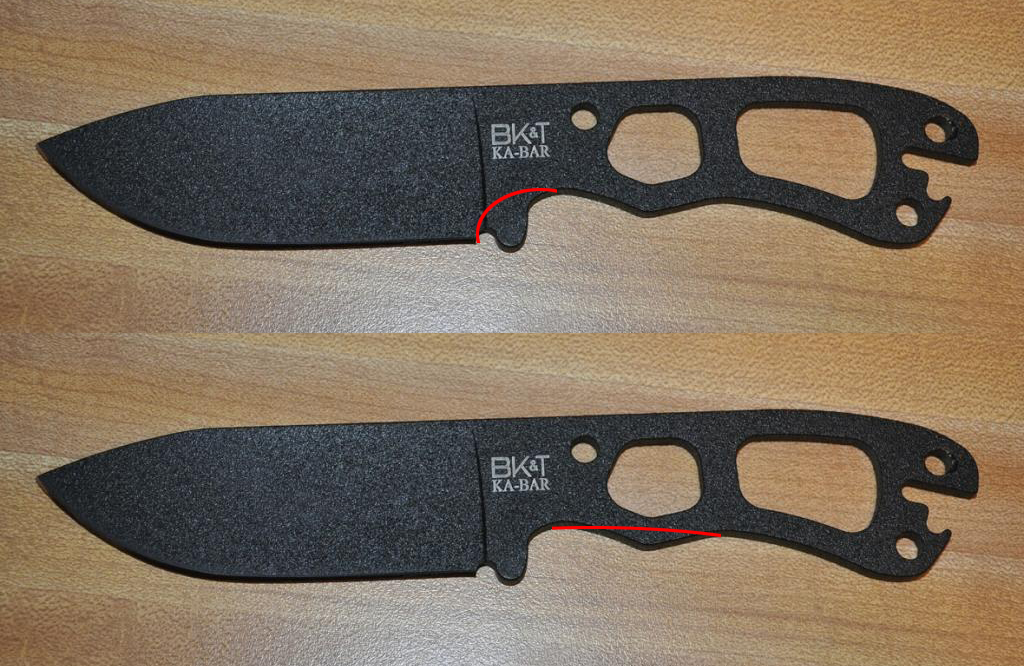

I took a chance on a BK11...it arrived today; and the first impressions aren't good. When I take the knife in hand, the first thing I notice is that the guard sits right in the middle of my index finger. Hmmm, that should be easy enough to fix - I'll just slide my finger back into that curve behind the guard. Nope, doesn't fit there. I've tried adjusting my grip, and there is just no comfortable way to hold this knife.

Here is where I view some mods happening to improve your grip comfort
Yes.
do both and you'll almost have a Daizee handle. ;-)
Definitely the first one is necessary. Only reason I didn't do mine was that it was D2 and Camillus. When I get bored I may buy a Kabar bk11 to make that mod and to smooth out the drop point.

The 11, 14 and 24 trio has much to offer for customizing. Make your drawings, search the threads and have some fun. Whatever you try first, make sure it is reversible. Making different scales or factory micarta, for example. Once you remove metal you're stuck.
To be honest, I hadn't even considered the second option this morning; I was leaning toward a slightly different version of the first image, except not starting right at the edge of the cutting surface. (I've already got a hole in my index finger from hitting that corner, lol.) I''ve got some scale material on the way...maybe I'll put the 15 on hold, and divert to this one (the stuff I ordered for the 15 & 16 was backordered, so I grabbed a substitution that I was going to remove when the right stuff comes in anyway).
That's good advice...but, in this case (for me at least), removing metal seems like the best starting place. If I don't post pics by the end of the weekend, it didn't go as planned, lol

I don't think I'm going to call this finished; but it feels a lot better already. (I basically stopped because I was too tired , and that's when ugly mistakes happen.)

I'll probably soften the curve between the index and middle fingers, and maybe round & extend the top index finger curve to blend it in a little. I'll see how I feel the next time I pick it up.

Looks good, and good judgement to take a break before things got ugly. The factory micarta really makes a huge difference in my experience. I'd recommend trying that before taking off any more metal. I think you'll be very happy with it.
I've got other handle material on the way - it was supposed to be for the 15 & 16; but I had to do a substitution, so I was only going to take it off when the stuff I wanted got in. I decided that I'll use the substituted material on this, so I don't have to do double work on the others. I should be able to have pics by next Friday, at the latest.
And, to everybody that asked - thank you...it feels a lot better (but could probably use a little more work). As you can see in the second image, I started etching the logo after I stepped away from the reshaping station.

The final cut:
I tried to keep it pretty clean, and avoided making sharp/rough edges...even went back and touched up the sides
