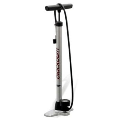

You can pump up a regular car tyre with a bicycle stand pump in less than 5 minutes, to top off would take 1 min tops.
$30.00 at Amazon
Sears sells a very nice electric air pump that plugs into your cigarette lighter. It has a detachable air pressure meter included and it costs about $35. I keep one in each car.
