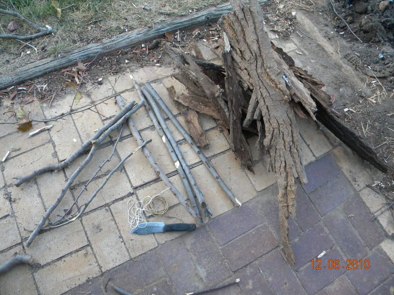

Well almost, I used 1 small peice of 550 gut for the top lashing.
But the rest was all gathered in the woods, Cottonwood bark, green sticks, and milkweed cordage I made a while back.

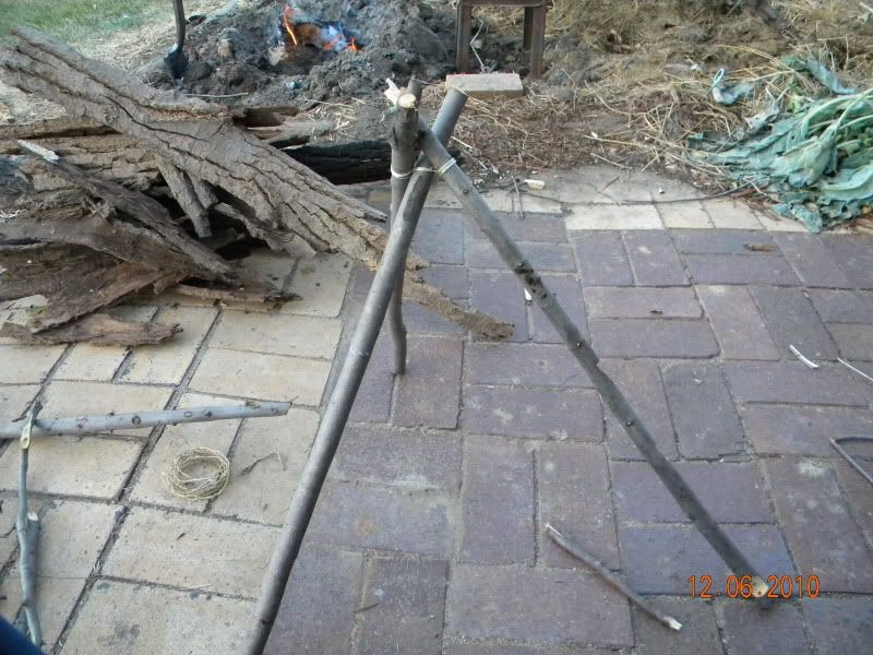

First thing I did was get a fire going, so I would have a fire to produce coals for use in the smoker.
Then I started on the tri pod, making sure to use green wood so it won't start on fire easily.

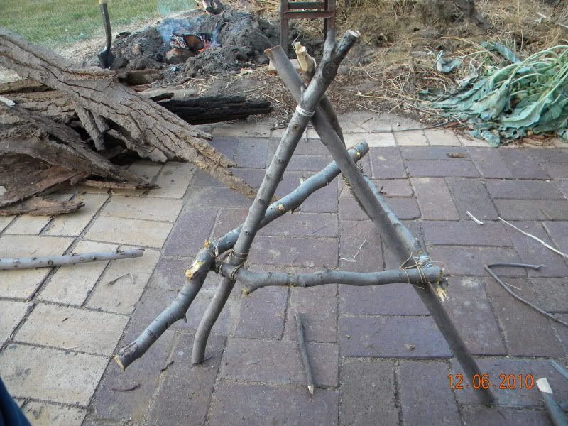

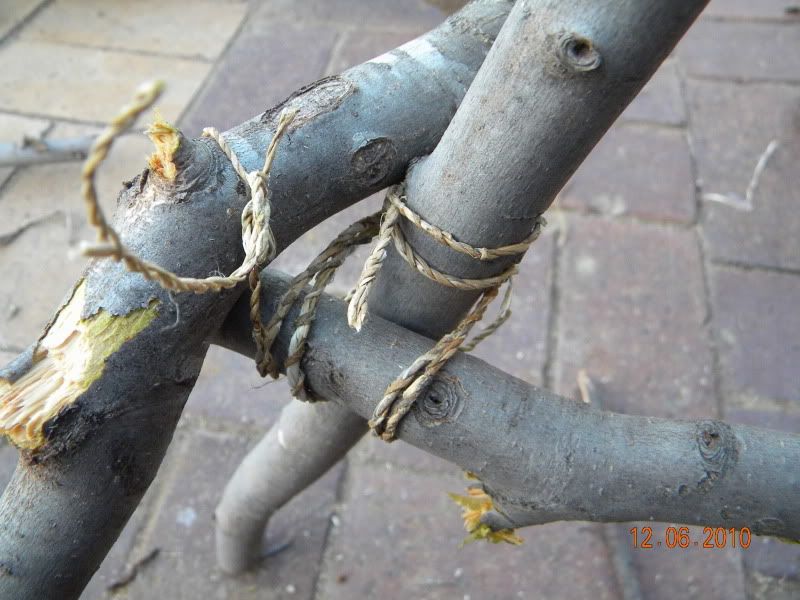

Then lashed my "rack" on to the tripod.
Using milkweed cordage

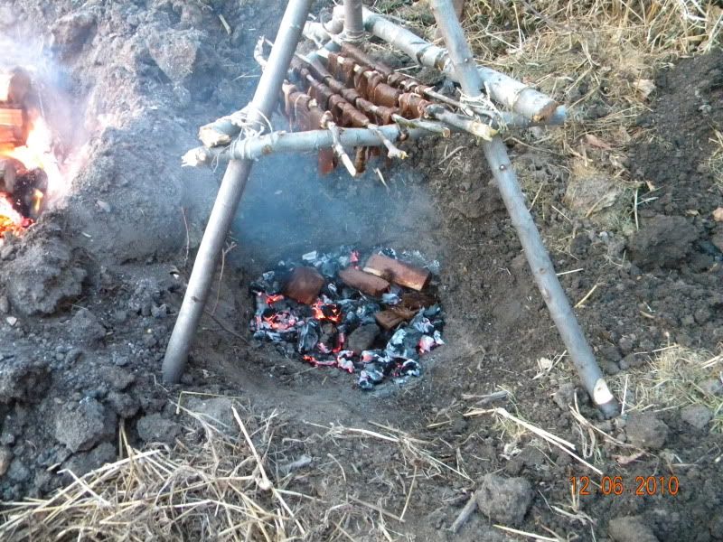

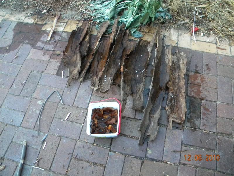

I also soaked my cottonwood bark down with water, to help it not catch fire as well (Remaining Calm of course!) And my applewood was soaking in the bucket (to be used for the flavor)

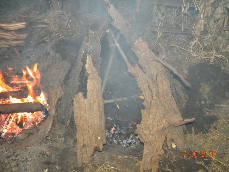

Then I dug a small pit, to place the rack over top of. My thought behind this is that with the pit the coals are further away from the meat without me having to buile a bigger tripod.

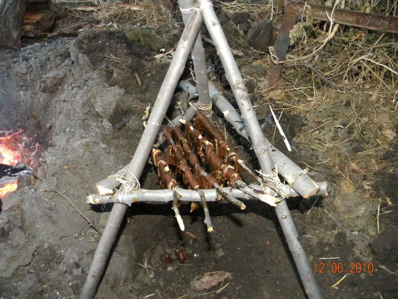

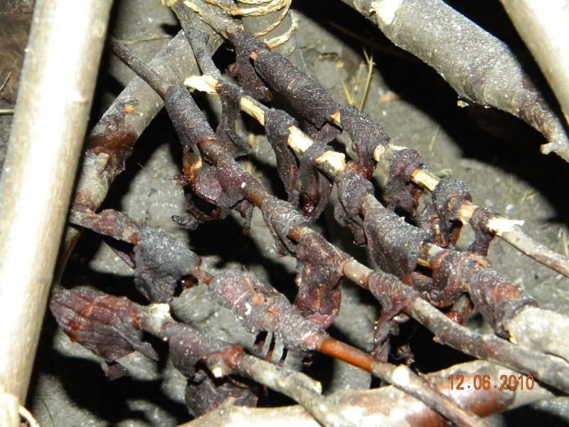

I placed the vension on to green sticks and layed them on my rack, making sure to have space between the meat for the smoke to get to it all.
Added the coals and got the smoke to rolling

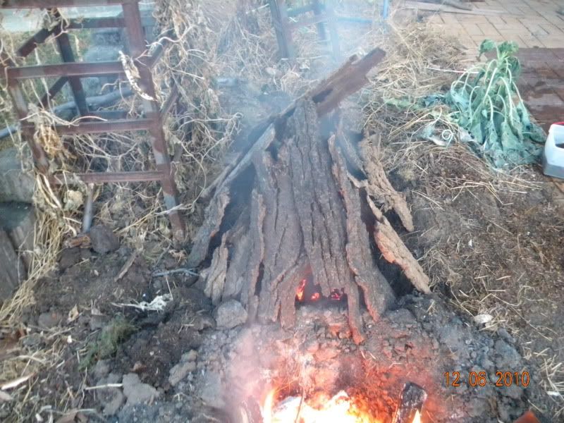

Then placed all the cottonwood bark around the tripod, doing my best to seal it up and keep the smoke in and the air out. TO help keep the flames down and the heat in.
I then used dirt to build up around the bottom and seal it better.
And now I'm posting this while I wait for it to get done, I will check it and add coals and wood to smoke as the night goes on...................

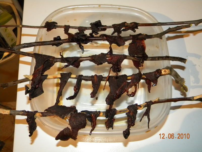

and after about 3 hours.........................
Yummy, smokey goodness!!
And its just as dry as if I had used my dehydrator! The wet looking spots are fat. I must say this is some of the best jerky I have ever made!! Out of this same batch I put some in the dehydrator and the smoke flavor really adds to it!
Wouldn't be much more work to make the tripod a little bigger and put alot more meat on! I will be doing this again.
