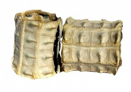

I have zero practical experience with back straps, but I've got a piece and I think I'd like to make a cuff from it. How tough are the scutes, but more importantly, the skin covering them? Is it tough, or will it wear quickly?
For us new guys, what are scutes?
You know the bumps on the backs of alligators and crocodiles? (and dinosaurs for that matter) Those are boney protrusions called scutes. They are covered by skin and I'd like to know if it is particularly durable or not. :)
Anthony. in general back straps are a pain in the ass, and they go down hill from there. The scutes are very bad news for a sewing machine and little better for hand stitching. I think they are very durable (try cutting through one with your best knife). They can be sanded down using a belt sander or similar, but the underlying area is still can not be penetrated with anything less than a drill or an awl and hammer. (I buy mostly bellies which are scute free.) The sides of the Alligator backs, void of scutes, are quite useable and make beautiful inlays. I will list the positive points of horn back straps below.

Fortunately the strap wouldn't need the scutes disturbed. It'll be quite wide, but that works for me given my style. I'm thinking I'll line it with pigskin because the flesh side is nothing close to flat. Then put a line of eyelets on either end and use cord or leather lace to tie it up. Just gotta figure out how to incorporate some color.

Anthony, this is off the topic of wrist bands, but here are two examples where I used the horn back. In the case of the full front I laid it out where the stitch line on the edge of the sheath would make very little contact with the scutes and it worked out just fine. The second example of an inlay, I measured and designed the inlay window width so I could center two rows of scutes and trimmed the piece so that when stitching around the window I was going trough the area of the skin between the scute lines and it worked just fine also.
Based on your photos you could trim down to a couple of scute lines and have smooth sailing on the edges all the way around.

About the edges of the overlay, how did you finish them? Did you not have a problem with how the flesh is not flat?

I sand the back (flesh) side of mine more often than not. This helps flatten the piece. Belt sander works wonders.
Those hornback crusts are some of my favorite to work with because they are so thick and gnarly. They are limited in their uses as they arent very wide though.
