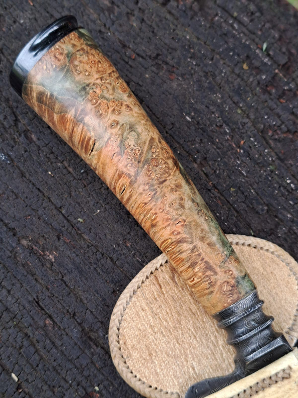

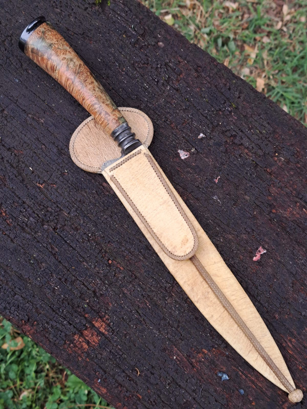

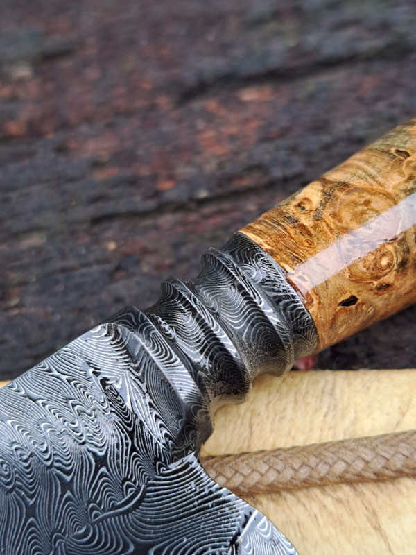

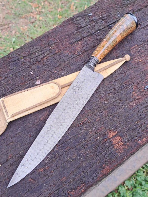

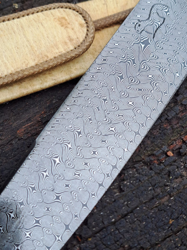

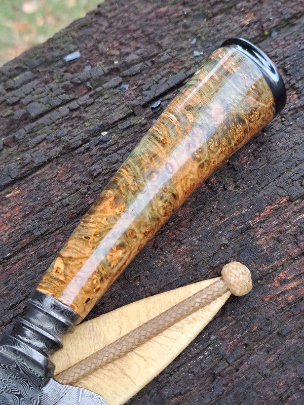

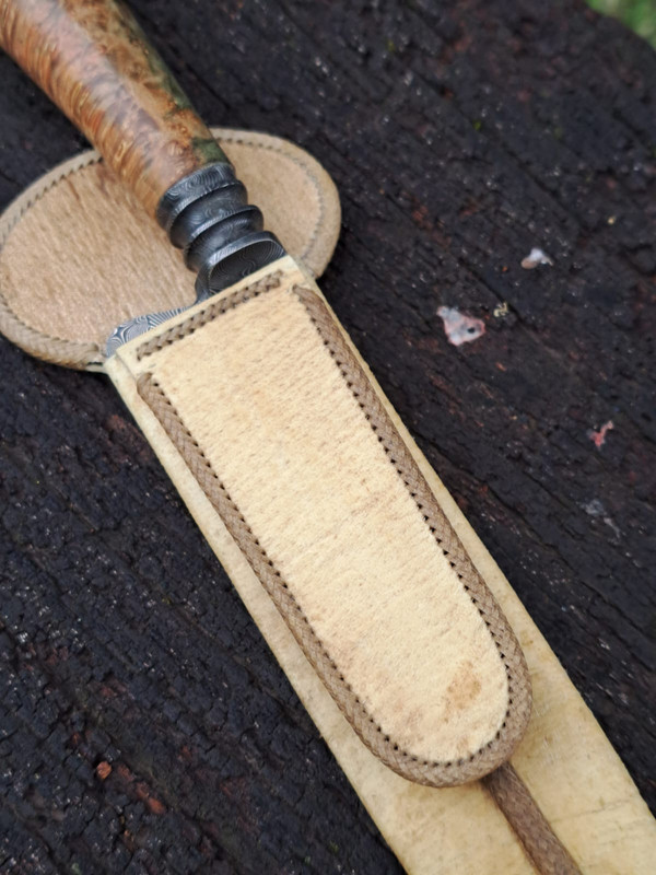

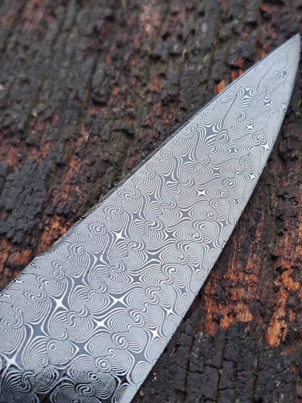

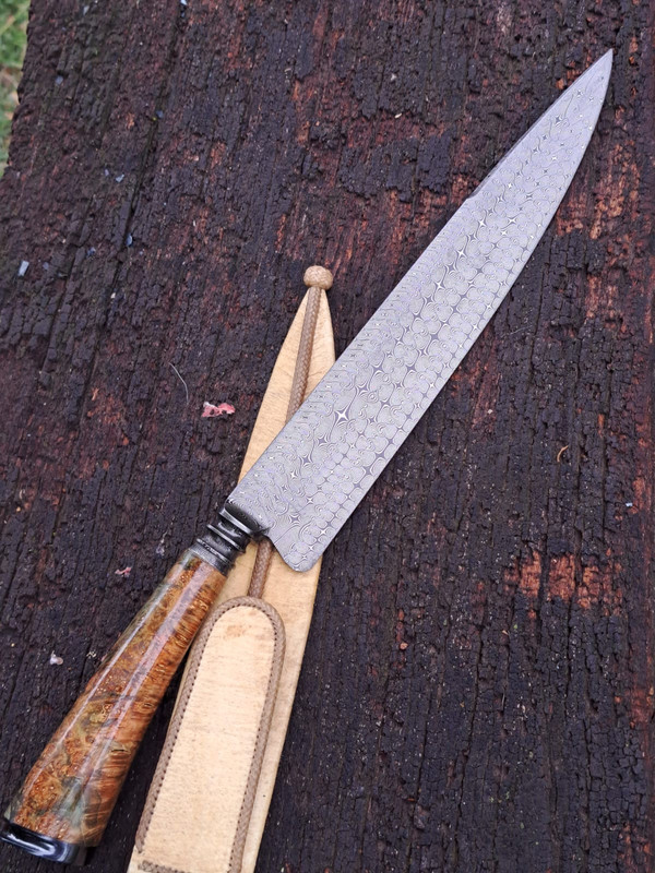

Without a doubt, it is one of the moelos that I like to make the most since it is very traditional from my land, in this case it is my interpretation of the gaucho knife, made with modern materials! The damask is Turkish pattern and has 4 bars of 50 layers each, the button is integral and has file work, the wood is stabilized elder burl, and the pommel is blued iron.
The sheath is made with traditional Argentine rope techniques. hand-stitched with leather straps.
the useful edge is 7.9 "and its total length is 12.6"
Hope you like!
