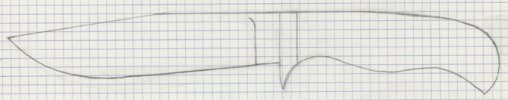

Although he makes primarily high-end folders these days, Gayle still has fire in the belly for extreme performance fixed blades. In conversations over a few weeks last winter, I was delighted to learn that we see eye-to-eye on many performance aspects of knives in general and hunting knives in particular. He recently honored me by building a high-efficiency cutter in his favorite CPM M4 steel, based on my hunter design:
Overall length is 10" with blade length from bolster to point of 5". My original sketch:
Compared with my original design, this one rounds off the bird's beak at the butt and has a full/tapered tang, as he's using the same construction method used on his competition cutters, including HSM (horse stall mat) slabs for the handle (wonderfully comfortable and secure). From my sketch, he incorporated the downward angle of the edge as it comes off the ricasso, which preserves the deep belly I prefer for skinning, but he lengthened the clip for a finer point, which I find I like. Instead of a conventional guard, he used double-pinned, tapered bolsters which are very comfortable, especially when choking up. He even heat treats the 416 bolsters, by the way. The knife balances on the rear edge of the bolster--just right.

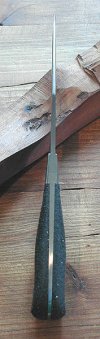

Over the course of setting many cutting records using his own knives in BladeSports competitions, Gayle has refined both the heat treat and high-performance grinds achievable with M4 to an amazing degree. Blade thickness on this hunter is .14" at the spine/ricasso, with distal taper forward from the plunge, flat ground to about .005" edge thickness in the forward part of the blade. The angle for the master grind (primary blade grind), which Gayle calculates precisely prior to grinding using a trigonometry formula, is only about 7 degrees included. Heat treated with an innovative directional air quench Gayle developed himself, the hardness is 61 HRC.

The view topside:

I need a little help to understand this:
"The angle for the master grind (primary blade grind), which Gayle calculates precisely prior to grinding using a trigonometry formula, is only about 7 degrees included"
Does this mean the angle from the spine to the edge is 3.5 degrees per side ? If so, it doesn't seem enough to go from a spine of 0.14" to 0.005" at the edge, so i think the 7 degrees refers to something else ?

Hi Roland--thank you for your remarks and for the opportunity to clarify. The 7 degree angle would be the angle at the juncture of the two blade flats--where they would intersect, if that angle were followed out to the intersection. This blade isn't ground to zero, but almost, so the point of intersection is beyond the edge and essentially hypothetical. With the blade thickness at the shoulder of the edge bevel measuring about .005" thick in the belly-to-point area, it's a very nice, thin grind.
