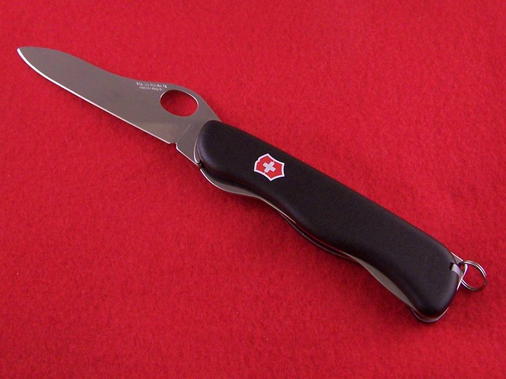

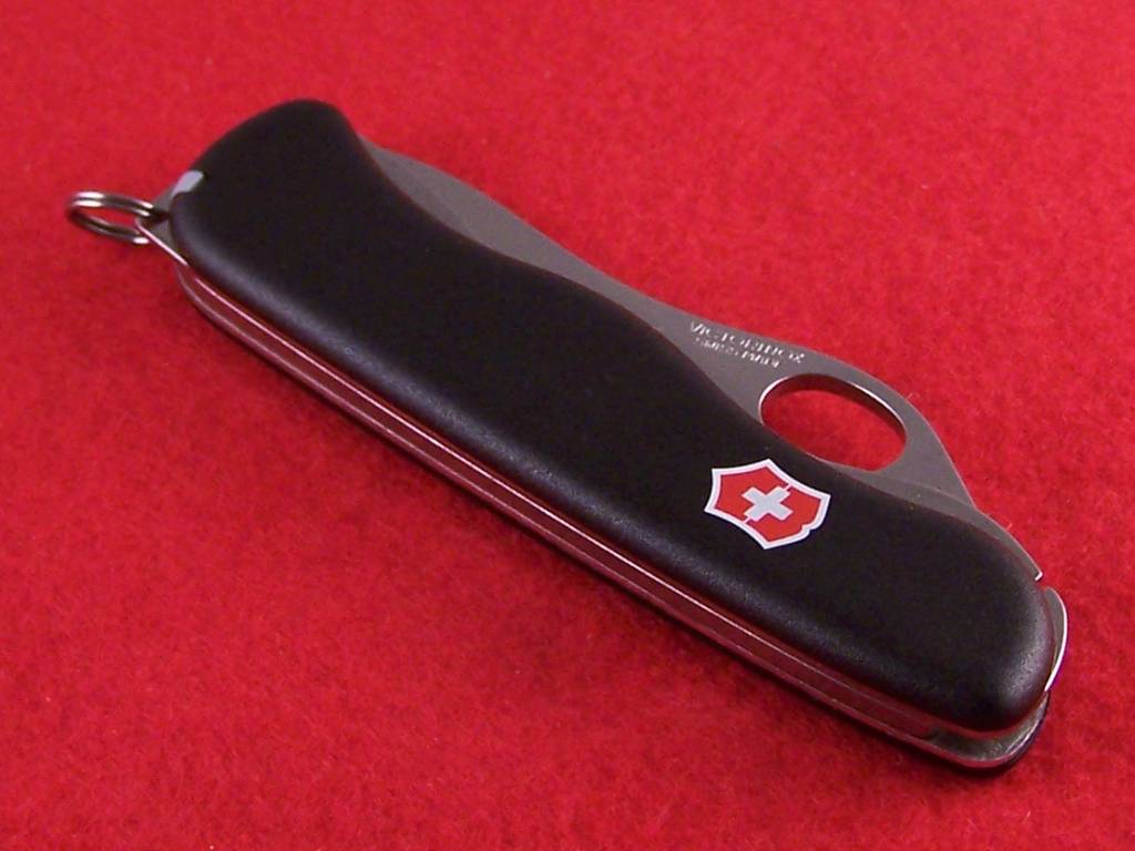

FWIW, while most of the liner locks on the market today are "Walker style" liner locks that provide excellent "flickability" at the expense of minimal "self close" and poor blade retention, there are still some liner locks that operate very much like back locks and slip joints because they rely on a back spring, rather than a tiny ball to provide those things.

Victorinox Sentinel is the one I'm most familiar with...
...but I'm sure there are others as well. I know Case made some liner locks with backsprings years ago, pretty sure they still makes one or more that way. Heck, before Michael Walker came up with the ball detent style liner lock, all liner locks were built that way. Most of the locks were fairly flimsy, at least some of the older Cases used brass liners.
