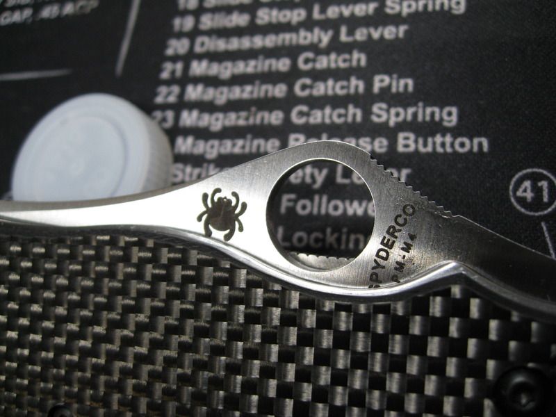

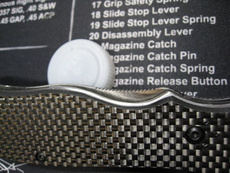

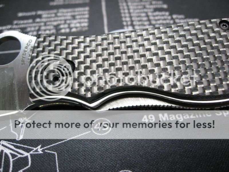

I've never been a big fan of liner locks but was browsing the Bradley Hard Use thread http://www.bladeforums.com/forums/s...ley-Hard-Use?highlight=gayle+bradley+hard+use last week and with all the positive things that were being said about this knife, I figured I'd get one while I still can. Being impressed would be an understatement. There are so many things I fell in love with but I could not get used to the lack of access to the lock release. Really, the only downside with this blade IMO. So I remember coming across a couple posts where guys were fixing this and figured I'd try it out myself.
So with nothing more than a dremel and some sand paper I gave it a shot. I started it yesterday and made a little difference but I wanted a little more access. So I broke it down again and here is the end product. It's not perfect but I'm very happy with it and can't wait to put it to use.
Thanks to powernoodle and paulhilborn for posting your pics in that thread. Without them I don't think I would have tried this but I'm glad I did. What a great blade!

What I quickly found out is the liner was catching my thumb when trying to release the lock and it felt like I was scraping my thumb too much. I could get away without the relief cut if I was just using it once in a while but I was playing with it too much and figured I'd give it a try. With the size of these liners and the pressure needed to disengage the lock I'm not worried about accidently hitting releasing it.
If you want an easier release and are up to the task I recommend giving it a shot.
After reading this thread and deciding I'd prefer just a bit of clearance on the GB2, I modified my knives (I liked the result so much on the GB2 I went ahead and did it to the GB as well). Nothing against the original design, which was done the way it was as a design intent, these now are immensely more usable to me.
For those considering doing this, full disclosure... I have some experience modifying knives and all sorts of mechanical things, and some machining and related experience - but this DIY was extremely easy. I'd say the first knife took me 40 minutes because it's the first time I'd ever taken apart a Spyderco of any sort. I went slowly and made sure I had all the parts organized. Plus I gave it a good cleaning and polished the washers going back together. The second knife took 20 minutes, tops
