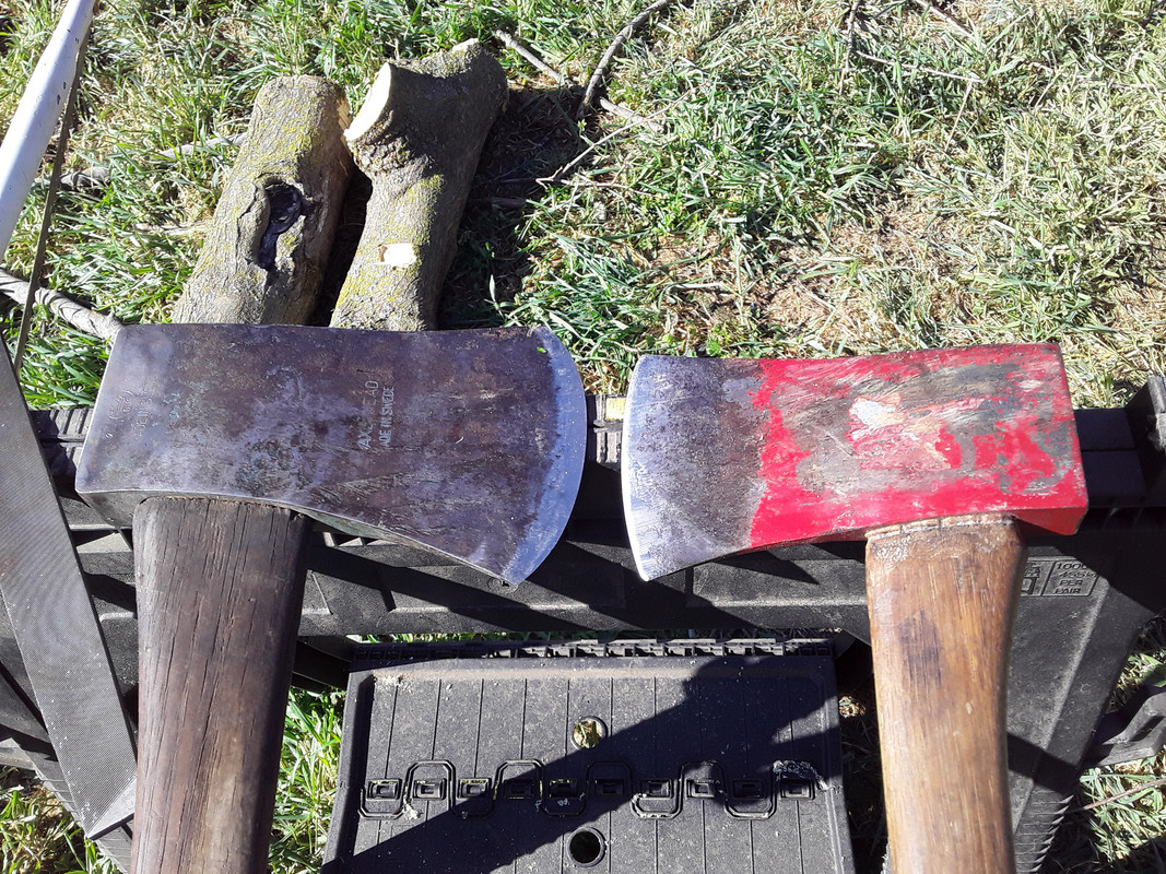

I had some axe work to do, and I was using the TT woodslasher boys axe and an old GBA 3.5lb that came from my uncles house.
I grabbed a file to sharpen both and I was surprised just how much easier that GBA is to file.
I always knew the GBA axes were the budget imports of the day, but I figured they had to at least be as good as a 60's woodslasher.
I don't think the steel has been burned or anything.

Them newer TT's are harder than a lot of vintage axes. If we are to judge a "good" axe by the hardness of the steel well then the modern GB's are going to be as good or better than any axe ever mass produced.
The swedish axes were right inline with their competition of the time. I don't believe the price difference had anything to do with materials or workmanship.

I have nothing bad to say about the vintage swedish axes based on my limited experience, I was just surprised by the hardness because I've always been told older axes were harder and expected the 60's woodslasher to be a bit softer.
I had never sharpened the woodslasher at the same time as another axe and figuring it should be on the softer side I was even more surprised that the vintage GBA proved to be softer.
If the 60's woodslashers are generally on the harder side, than I suppose the GBA would likely be on par with my other axes if I file tested them all.
