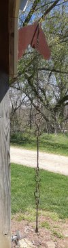

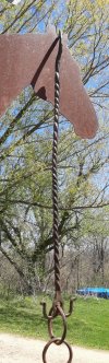

My fireplace crane, now serving as a potted plant holder over the dog's house. Not fancy but very stout. Appears to be blacksmith made.
Trammel hooks, the fanciest and longest set I own. Highly adjustable and sporting a ram's horn motif. Condition is good, collectable. It would take quite a tall hearth to utilize the full length of this device! T-A
