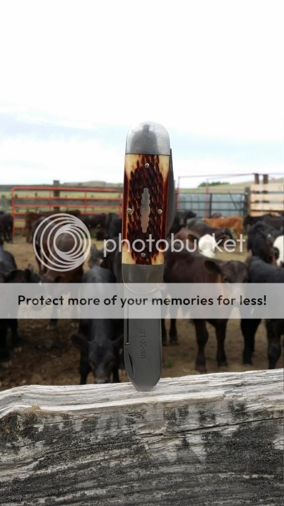

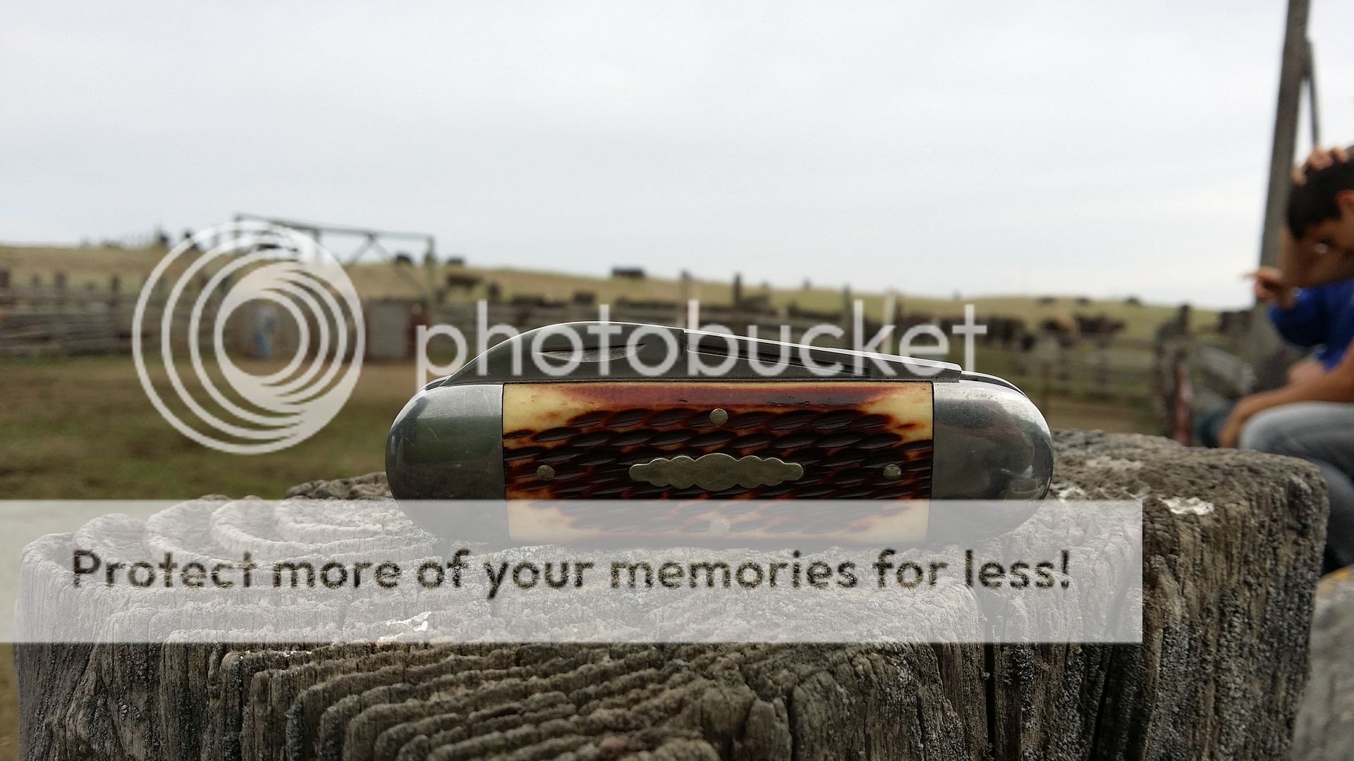

I have a steel toenail, and a #25 barlow with steel liners and bolsters. they will slowly patina over time.
I feel like the knives are more robust for having them!

#36 pattern.
Also called Sunfish, Steel Toenail, Elephant Toe.
That's a sweet looking knife! Along with what you have on the grill. I looked up the model and it has a .156" thick blade! Pretty thick for a traditional knife, but it is pretty wide too. How is the cutting performance?
Cutting performance is better than the thickness would lead you to believe. The swedge takes a good bit of the thickness off.
The blade is wide, so it is a pretty thin/shallow flat grind angle. The secondary blade is really thin and slices very well.

You are showing a knife and all I can see is that "gold on the hoof" in the background. Good looking calf crop.
Also wondering if the old corral wood would make good handles once epoxy impregnated.
Sorry, back to the conversation....
I do like the steel bolsters, where it will wear tougher; but don't think I like it as well as maybe NS on the liners. Also wish they would work more of a crocus finish on it.
