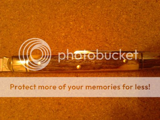

Good afternoon everyone, I want to say that most of you probably dont know me too well, but i dearly appreciate your knowledge and advice, and i apologize in advance for the long post, but this is important to me.
I ordered a GEC #89 melon whittler and its my first Great Eastern, and i was very humbled at first to have my hands on it since all the previous trad. knives i had before this were small fry. After a few minutes i started noticing the plethora of problems on it and i know some of you have had problems with GEC and i'd like to know how you handled them.

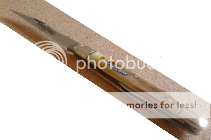

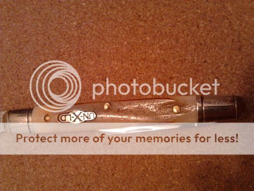

Firstly is the scales, they are terribly mismatched, pile side is dark rich brown, the mark side is whitish yellow; the bigger problem--one side is nice and full, the other side is concave. Literally concave, it looks terrible, but more importantly it is hard\awkward to handle (the bolster sticks out twice as much as the stag, see pic)

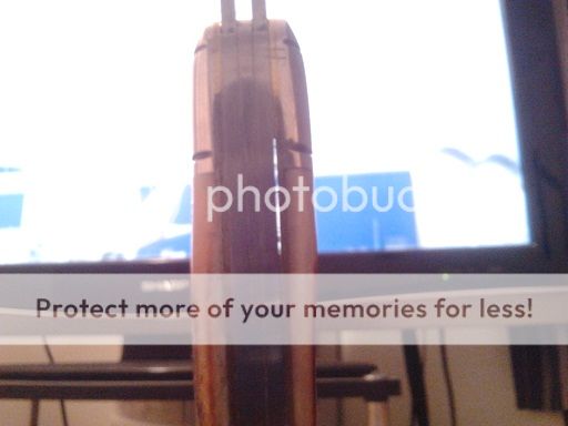

Second major problem is the gaps, between the liner and the springs on both sides. This sounds ridiculous but when i was taking the pictures i was watching tv through the gap...

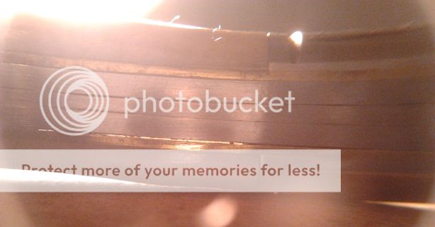

Thirdly the pull is all sorts of screwed up. It feels like the spring is dead on the primary and secondary blades. They open smoothly the first 1\4 of the way, and then the rest of the way its like theres no backspring. Im new to GEC but not to pocket knives, so i tried washing out the joints with warm water and working them and oiling them up. Nothing.

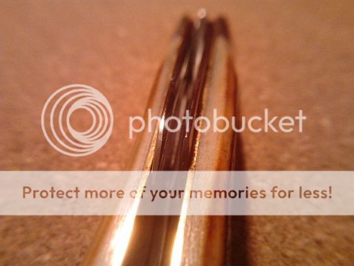

Fourth is the blade rub, which is to be expected on a multi-blade knife, but both the secondary blades are pushed into the liners so badly that it takes the same force to pull them away from the liners as it is to open them up.
Lastly, they burned the backsprings when they ground them to fit in. So i didnt think of this earlier, but if you burn the steel, it destroys the heat treat, which might be why the blades dont open up properly?? The blades are dull but that is fixable.

Only one. Send the knife in. They can't tell what the problems are or what thay can do about it if they don't have it in hand.
One other bit of advice. If uneven and mismatched covers bother you, never (and I do mean NEVER) buy stag. Uneven and mismatched is the rule rather than the exception with stag.
Yep, send it in. They'll do what they can to fix it for you; maybe replace it. There is a lot more variability in stag than almost any other handle material. But the gap problems and the burned springs are quality/workmanship issues. Good stag is very nice. It is hard to come by on production folders; GEC probably is more consistent than other manufacturers with their stag.

As for the handles, this may sound silly but are you sure it is stag?? It looks awfully like Primitive Bone to my eye. This material is frequently different and hard to match well. Perhaps you got a mis labeled knife, examine the tube does it have a serial No. does it have a certificate?

Even with substandard pics that does not look like stag antler. Neither should it have been sold with those mismatched scales. Send it back.

Well, it is stag. If for no other reason, then at least for the show of torching.
The stag is not very pretty, and that is enough; but the variance in thickness could not be helped by the deer that offered them up (he tried his best) :D
Those gaps are not common with GEC's, nor is any significant blade rub. The #89 does get more rub reported than most patterns because folks push in on the lighter weight blades when trying to get a nail grip on them and cause the rub. I very rarely see rub on the outside liners, but it does happen.
I see no, nor have ever seen, sign that GEC has burnt the backsprings. First off, they don't take some one size fits all spring and grind it to fit a pattern. They are cut to fit and any finishing that needs to be done is completed on low speed equipment. Any blade traveling issue is probably in the radius on the round end; but they would need to look at it to determine. If it has good action the last 20% of open or close, it is not a spring tension issue.

The handle covers look great to me; that's some nice looking stag/bone/whatever. The difference in thickness or color is normal for that material.
