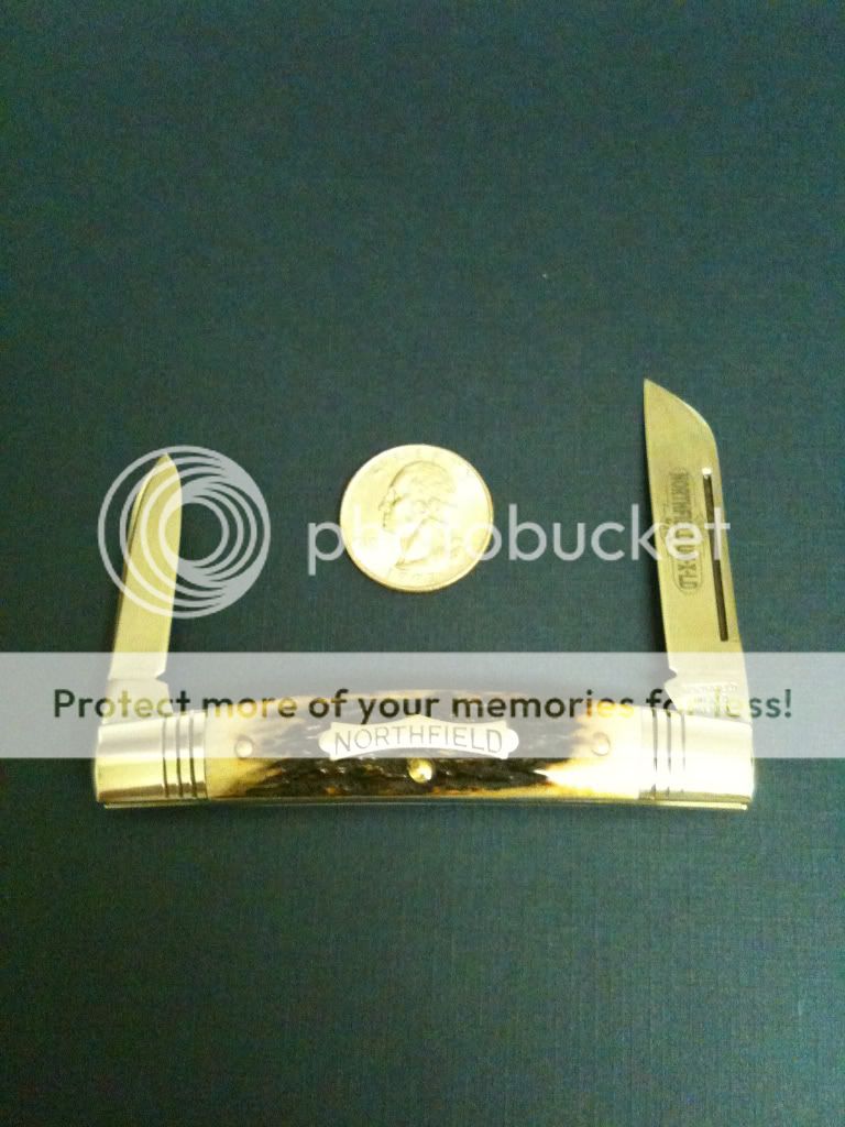

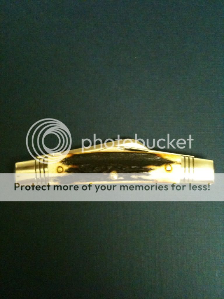

Well I just got my Half Congress and I figured I would do a quick review of what I've noticed so far. Please excuse the iphone pictures hahah.
It's a very nice knife. 1095 steel that took a great edge. It feels very solid and has absolutely no wobble when either blade is open. Weighing in at 60.3 grams or 2.125 ounces and 3 5/8" closed.

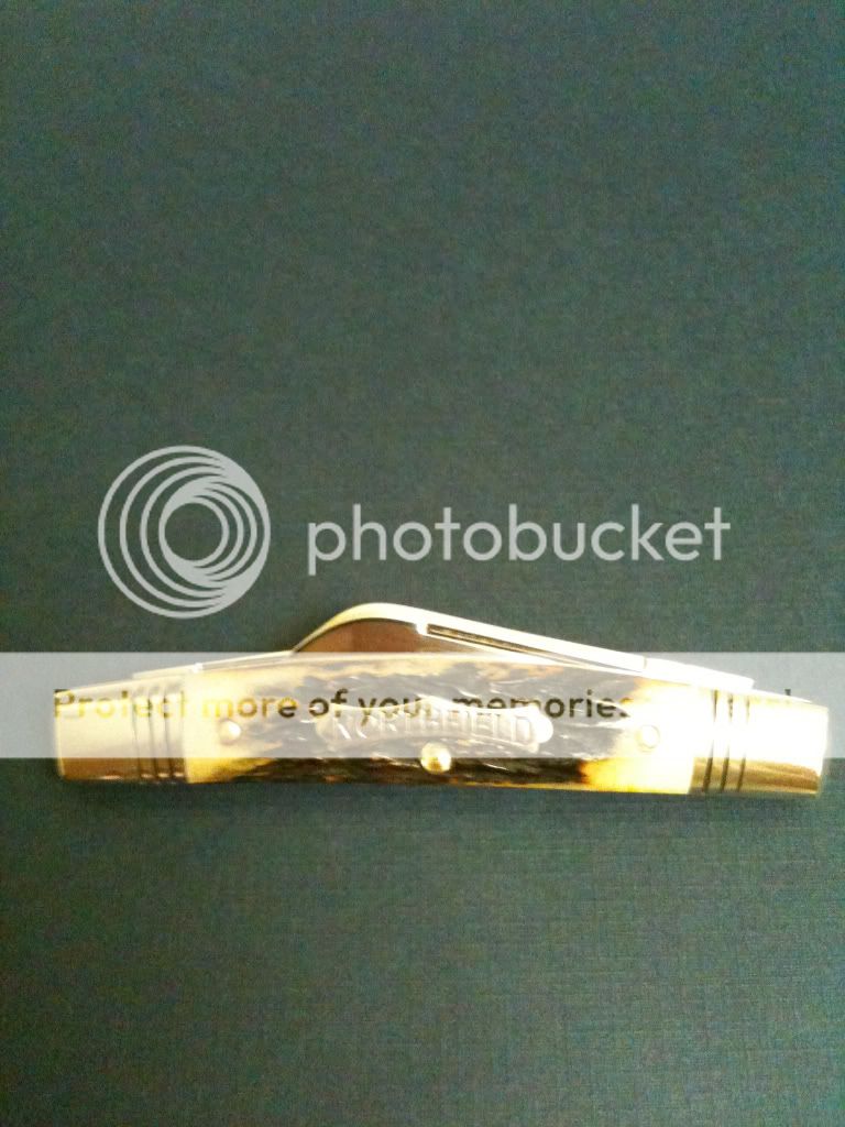

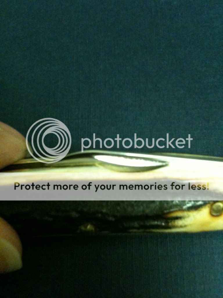

The small blade has a nice little cutout in the stag for easy access
The scales are well matched with no visible cracks. The shield is pinned.

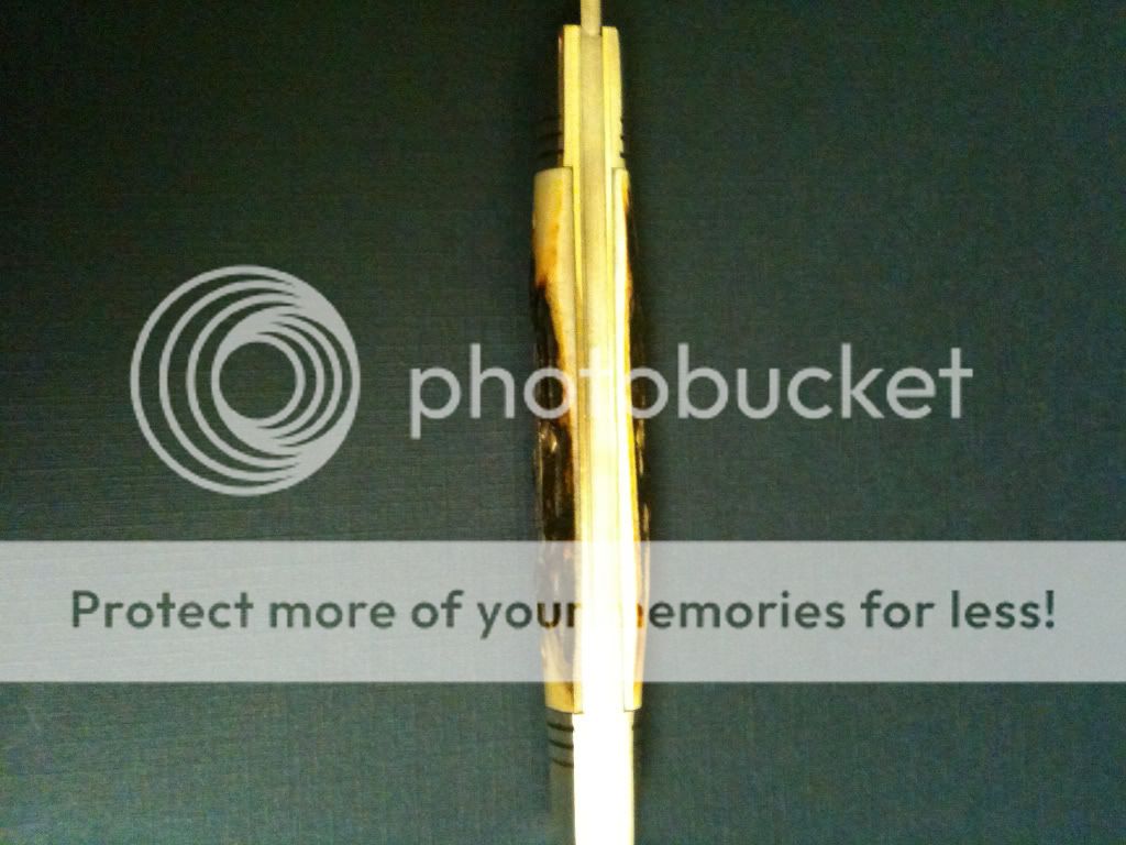

It has semi sunk joints. Neither of the blade tips are exposed like reported with some of the Sleeve Board models.
There are no gaps that I noticed

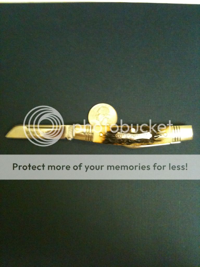

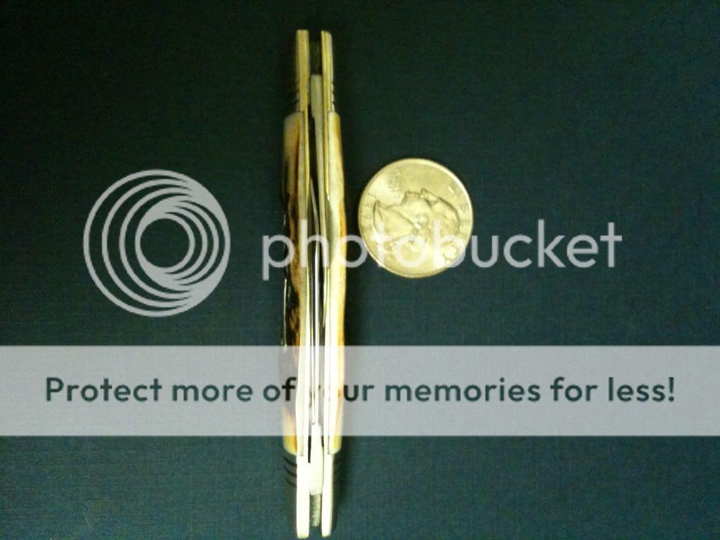

And it's pretty compact

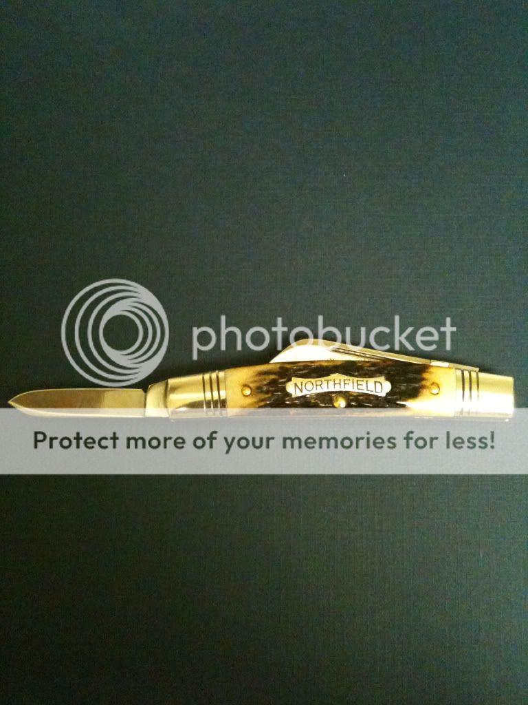

It's not a nail breaker. It feels good in the hand.The main blade has good strong snap but the small blade isn't as strong.. The blades weren't as sharp as I would have liked but I fixed that pretty easily, the backspring isn't flush in half on both blades they protrude a little but they're flush in open and closed. It had some scratches on the blade but I don't care because it's going to be used.
My opinion is that this a great production knife and while it has a few small flaws, no knife is perfect and these flaws are common to production slip joints from what I understand. I think it's a great knife and definitely worth the money.
