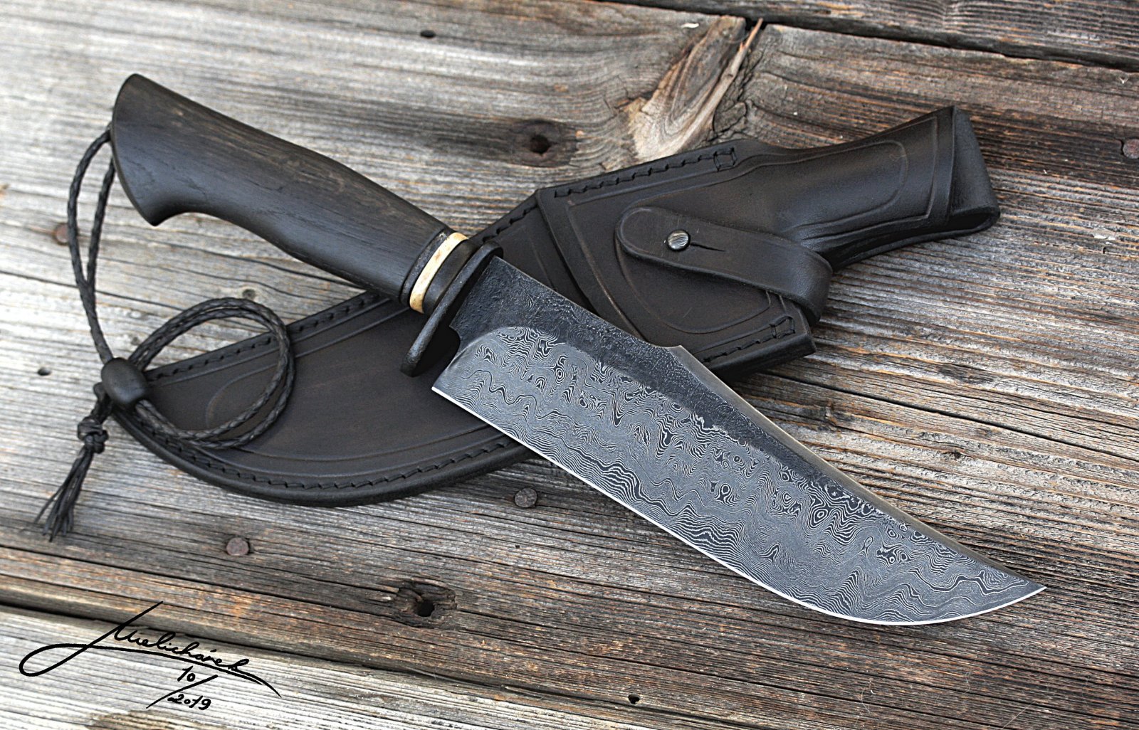

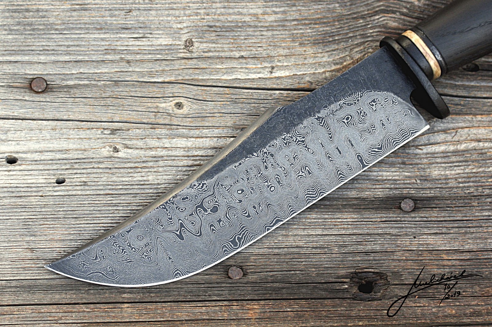

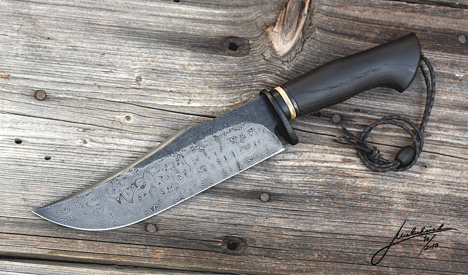

Hi everyone

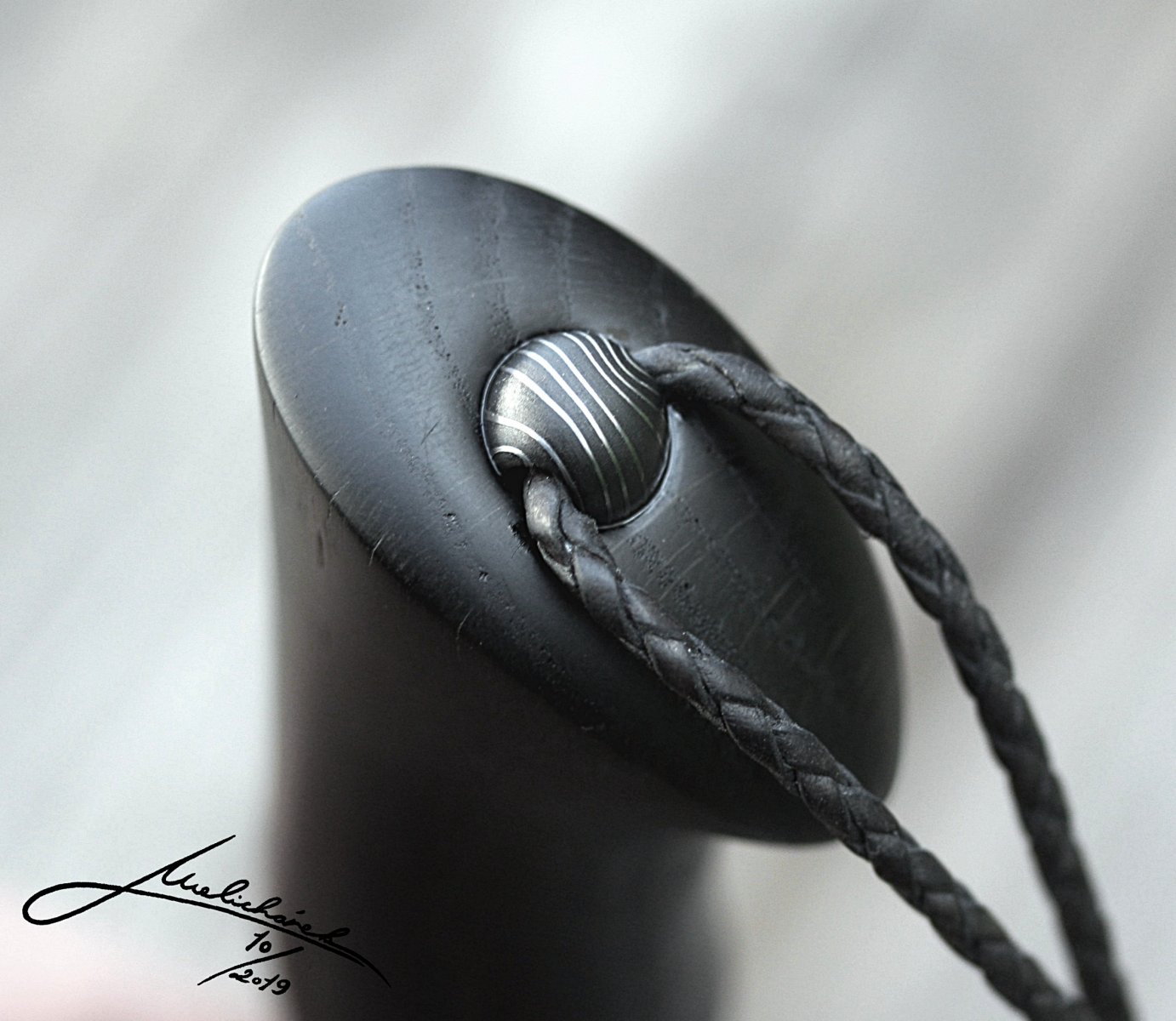

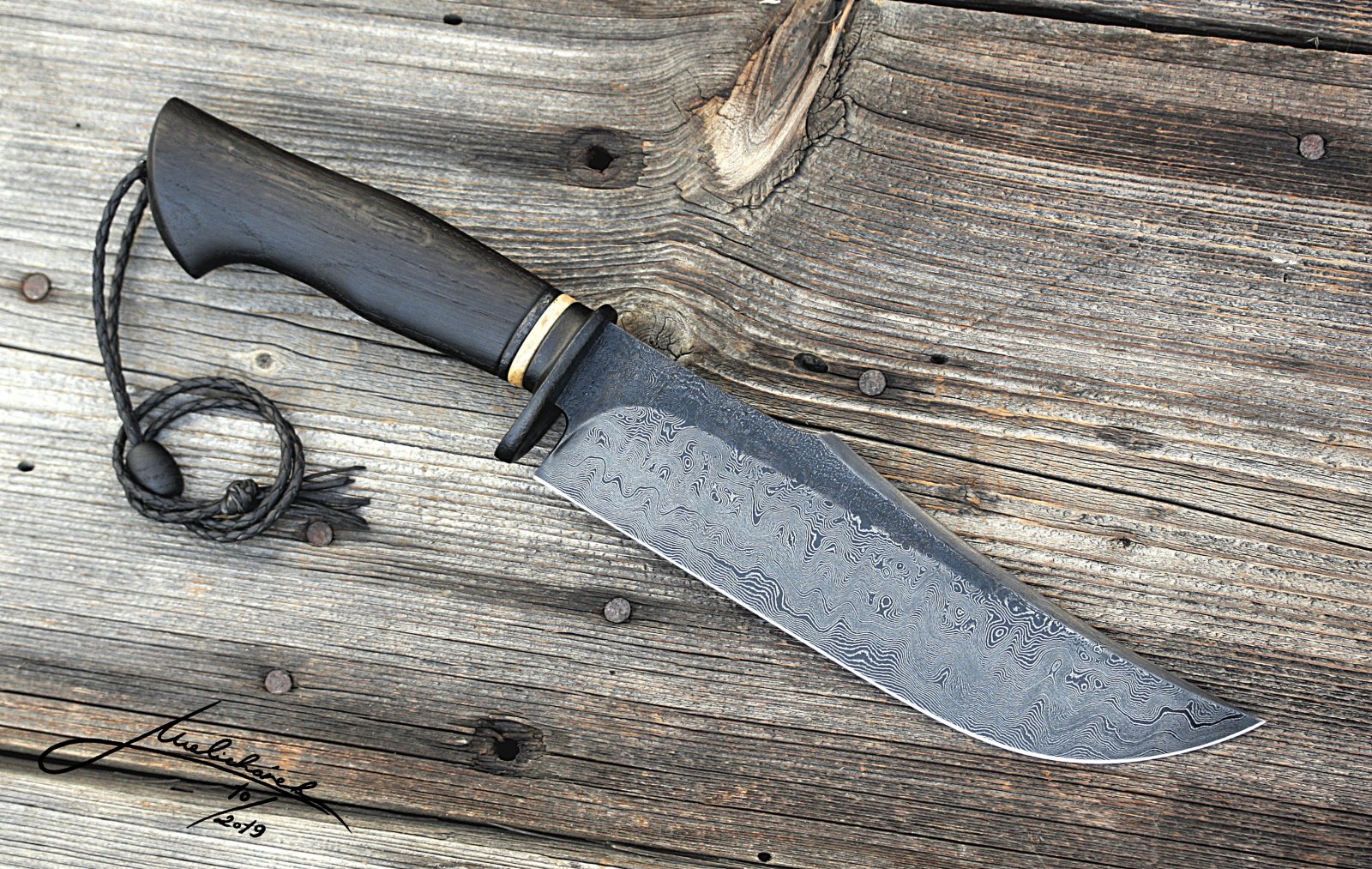

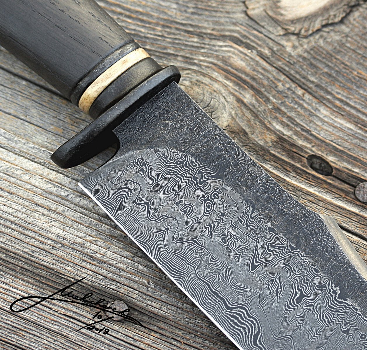

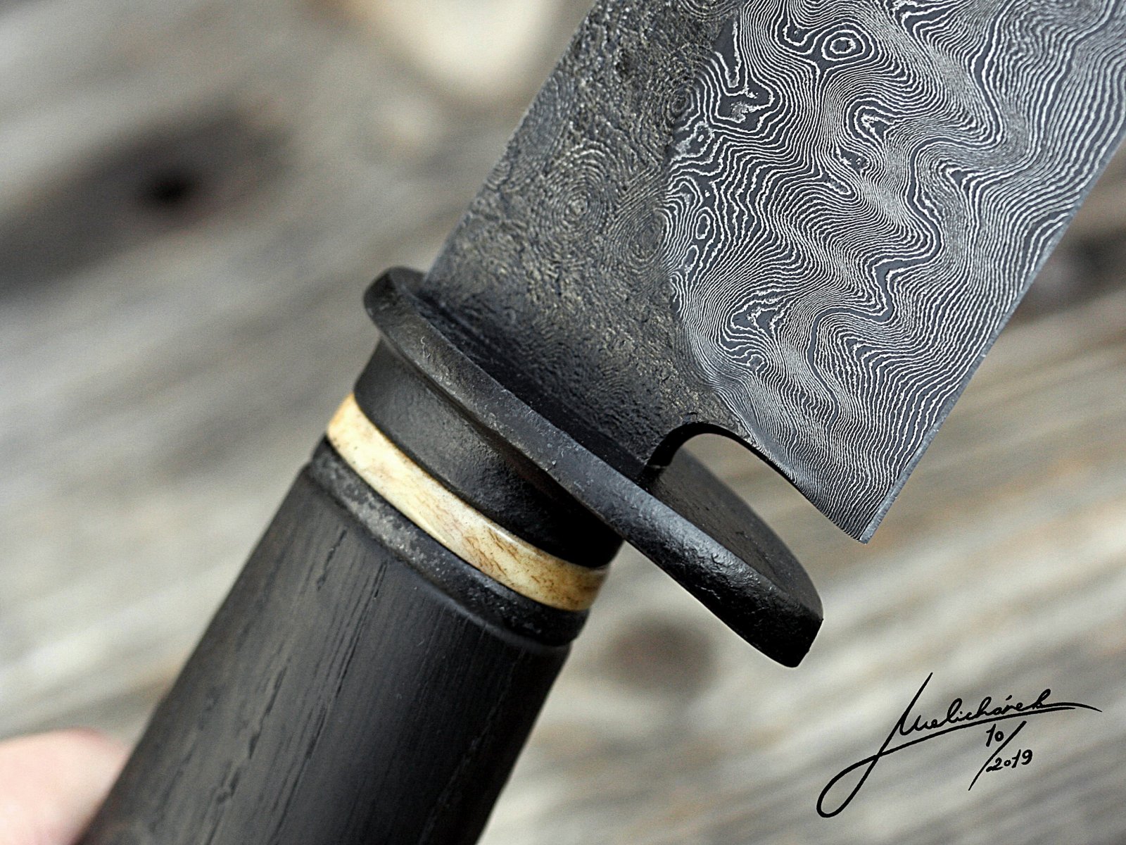

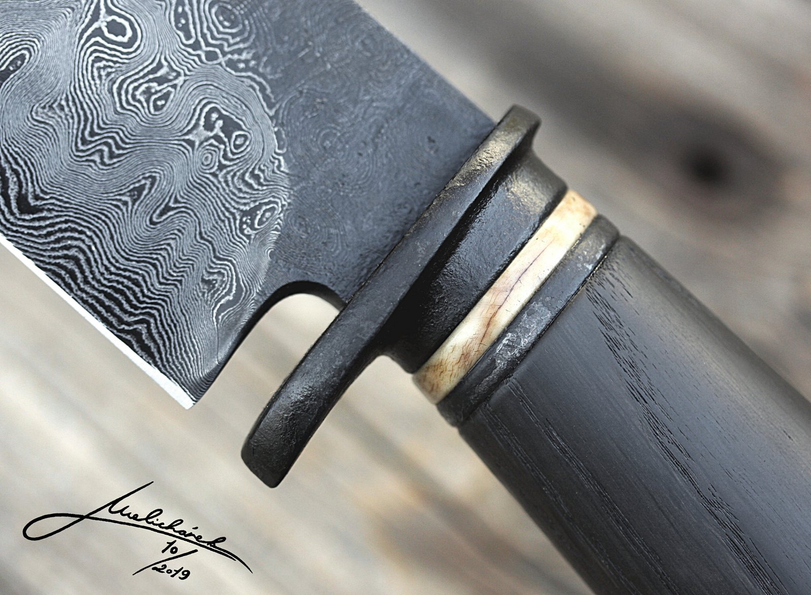

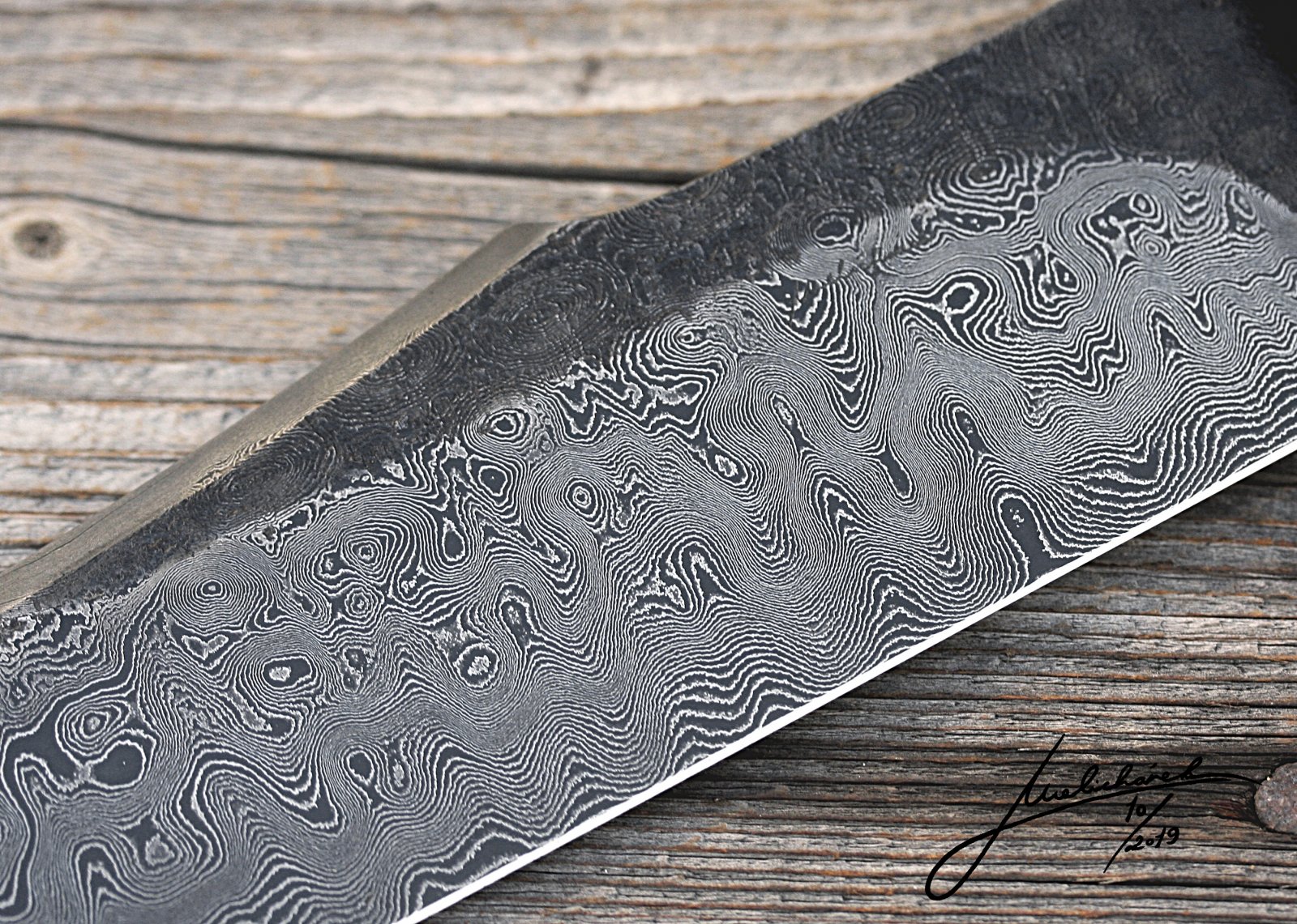

Here is my latest knife . Its rather bigger, rustical bowie. Until next time, Petr
GENBRI
Blade - Damascus steel 1,2842 (O2) + 75ni8 Uddeholm (15N20)
Guard- patinated mild steel , bone .
Handle - Ancient bog oak, originaly base of medieval bridge , around year 1300 . You can find some more info and pictures on my FB or instagram
Average length - 37,5 cm (approx- 14,8 inches) , blade - 22,5 cm (approx- 8,8 inches).
Blade width at widest point 58 mm (approx 2,3 inches )mm , blade thickness max 5,8 mm (0,228 inches)
