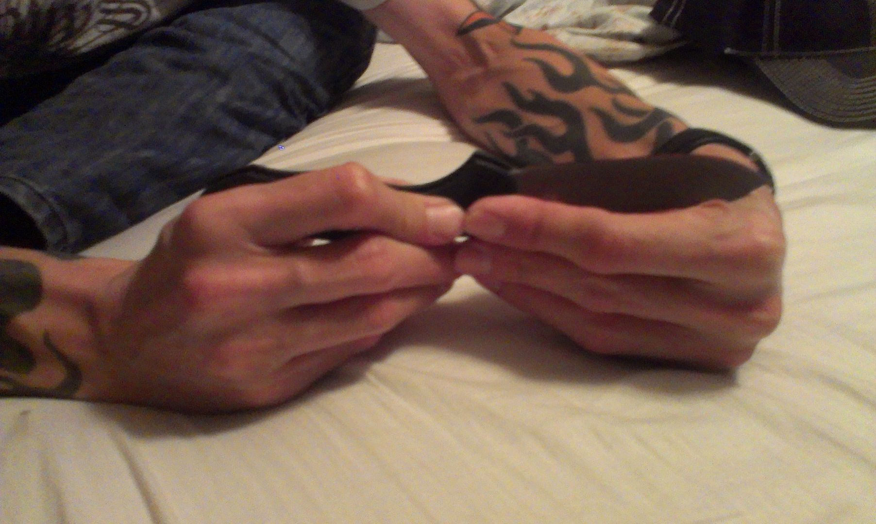

Whenever I get play I test my lock. I know my 810 isn't a frame lock, I just had it handy for a pic. The test runs the same regardless.
Hold your knife the way I have it in the pic.
Make certain that your hand is completely out of the travel path for the blade. Then, using your other hand, apply upward pressure to the spine of the blade keeping your thumb and forefinger on the pivot.
You should be able to apply plenty of force safely. I've never had a lock fail, but the method came from someone experienced with lock problems. I have had some rock appear, but so long as the lock doesn't fail I'm fine with a tiny bit of movement. I ask which knife because that statement doesn't hold true on all knives. I expect more from a CRK than from an inexpensive Spyderco.
